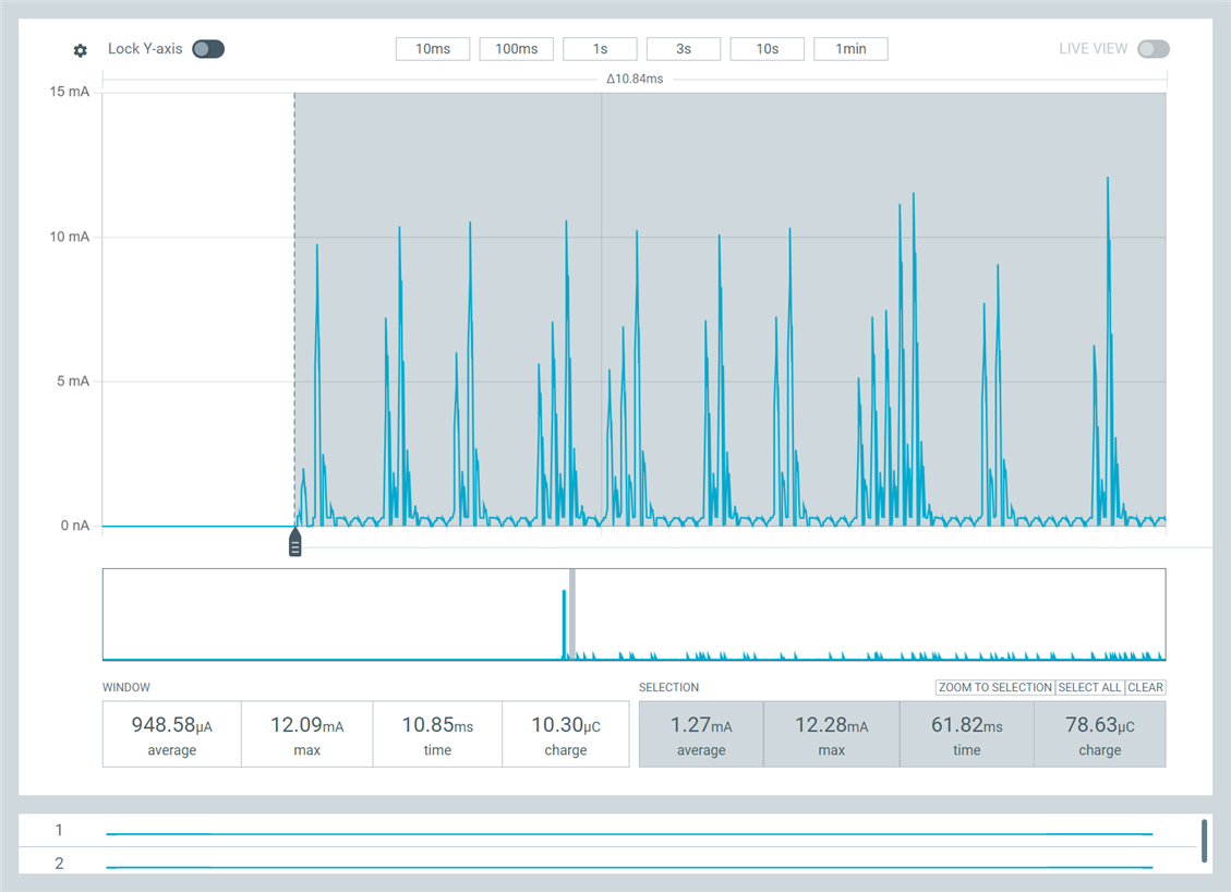

We are experiencing unexpectedly high and noisy power consumption when using PWM with nRF Connect SDK v2.9.2 on a nRF52811-based custom board, which is problematic because our use case for the nRF52811 is a board that is both ultra-low power and requires low noise on power rails while PWM is enabled. We'd like your help understanding what is causing this issue.
What is strange is that we do not see this same behavior when implementing identical code for this nRF52811-based board using the nRF5 SDK. We also do not see this behavior when using PWM with nRF Connect SDK on a nRF52840-based custom board. In other words, the problem seems to be specific to nRF5 Connect SDK running on the nRF52811.

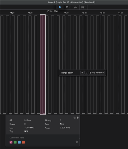

Our use case for PWM on this board is generating a 3.2 MHz clock to an external component. However, for the purposes of this testing, we are outputting PWM to a pad that is not connected to anything, to highlight the power consumption due to PWM vs whatever it is connected to.
Also, to simplify reproduction, all of our testing is performed using a modified version of zephyr/samples/basic/blinky, with main changed as follows:
    static const struct device *clk_dev = DEVICE_DT_GET(DT_NODELABEL(pwm_clock_gen));
    if (device_is_ready(clk_dev))
        k_sleep(K_MSEC(100));
        clock_control_on(clk_dev, 0);
    k_sleep(K_MSEC(1000));
So in our test, we sleep for 100ms, turn on the 3.2 MHz PWM output, and then sleep for 1000 seconds to contrast power consumption while our main thread is sleeping before and after PWM is enabled. Also, our nRF Connect SDK implementation relies on a custom, board-specific DTS file based on the nordic/nrf52811_qfaa.dtsi file (attached, named RC63_B25_V2_DEVKIT.dts.

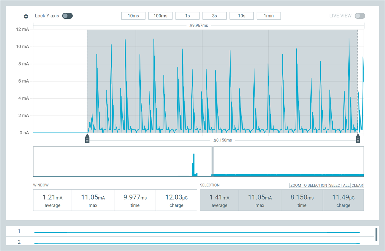

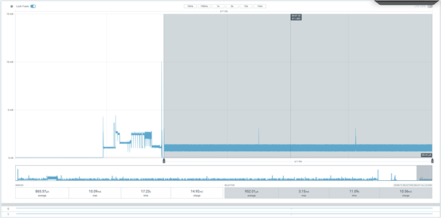

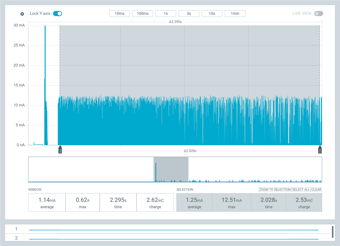

Figure 1 shows what we are consistently seeing on the nRF52811-based custom board using nRF Connect SDK and the code above. This figure shows a detail of power consumption at the end of the 100ms sleep and then after PWM is enabled. As you can see, power consumption is around 1.4 mA @ 3V, but even more strange are the huge, frequent, but irregular spikes up to 10 mA while PWM is running.
We see identical behavior if we continue to use nRF Connect SDK but eliminate PWM from the DTS and simply rework the test application to use the lower-level nrfx_pwm modules intead of the Zephyr clock_control driver.

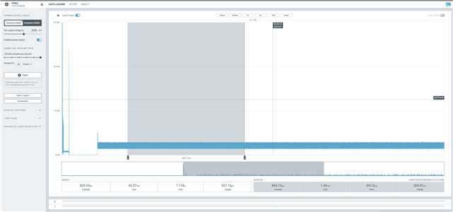

Figure 2, in contrast, shows what we are consistently seeing on teh nRF52811-based on custom board using nRF5 SDK and embOS RTOS and equivalent code based on the the nrfx_pwm driver. Power consumption is only 1.1 mA @ 3V and is very consistent once PWM is turned on, with no huge spikes up to 10 mA. This suggests a difference either in how nRF Connect SDK is configuring the PWM peripheral controller or a difference in how it is servicing PWM from interrupts or threads.

    It almost looks like there is something asserting or reseting on your end? What does the log output look like?

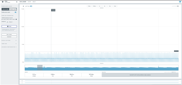

    Here is the sample that I used for testing, which yielded this result in ppk2:
    And 3.2 MHz (HFINT sourced, which is why its a bit off on my end) output:

  • Thank you for your response.
    We don't believe this is the case. Maybe I didn't make this clear, but when we see this high power consumption with huge current spikes after turning on PWM on the nRF52811 using nRF Connect SDK, we can see that the PWM output is working correctly on our digital logic analyzer, producing the required 3.2 MHz clock. So the MCU is definitely not resetting.
    We don't have support for printk logging via serial set up -- we've been using a custom logging mechanism based on Segger RTT -- and we don't have assertions enabled, so we don't think an assertion is causing this issue. But the point is, nothing is affecting the correct output of the PWM signal, despite the high power consumption and current spikes.
    Furthermore, in our actual application firmware, we turn on PWM for about 100ms toward the beginning our app -- and we see the same high power consumption and current spikes -- but our application continues to run correctly. So if there is a problem with a thread, it's definitely not the main thread.

    As we indicated, when we built our test using the nrf52840dk_nrf52811 board, and we ran this code on our nRF52811-based custom board, we see the problem. Without making any modifications, if we run this on our nRF52840 board, we do not see the problem, even though the nRF52840 can be used to emulate the nRF52811. I believe there is something about how Zephyr is treating the actual nRF52811 -- even if the nrf52840dk_nrf52811 board definition is used -- that is different than how this works with the actual nRF52840.

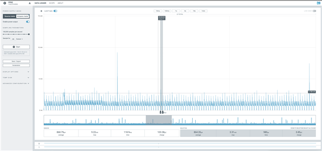

    As an example of this, it just so happens we have an older version of the nRF52811 board we're using that is based on the nRF52810. Again, this board is essentially just an nRF52810 with power circuitry (it's a devkit we created with a daughterboard connector, so if we don't have the daughterboard connected, it's just the nRF52810 with no peripherals attached).
    We took the code you provided and made a single modification to it, changing which pad was used for PWM output (to 0,14). We then created a build config for the nRF52dk_nrf52810, just as I assume you did (BTW, we always select "Optimize for Debugging" in the build config to prevent optimization). PWM output works as expected, but here's what the PPK2 output looks like:
    You can instantly see a dramatic difference between this and the capture you made on the nRF52DK. In your capture, you never see current spikes above maybe 1.3 mA once PWM was enabled, but here we're getting current spikes over 10 mA. In addition, the noise in your capture was evenly centered the 952 uA average, but in this capture from an actual nRF52810, we see spikes going down close to zero uA.

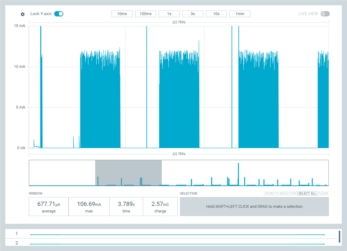

    Furthermore, I demonstrated that our code is continuing to run correctly even while this high power consumption and current spikes are occurring: I did this by modding your test code to turn PWM on for 500ms and then off for 500ms, looping forever. I see the expected output on the logic analyzer, and here's what I see in PPK2:
    Furthermore, you can see exactly how strange the behavior of the power consumption is if we zoom on the end of the 100ms delay and the start of PWM:

    Are you testing with the PPK2 in ampere meter mode, or in source mode?
    The issue is not the average, but the dynamic form of the current profile?
    It does sound like there's less capacitance in your custom board, as compared to a DK. If you add a capacitor, lets say a 100 uF, does this improve the peaks?

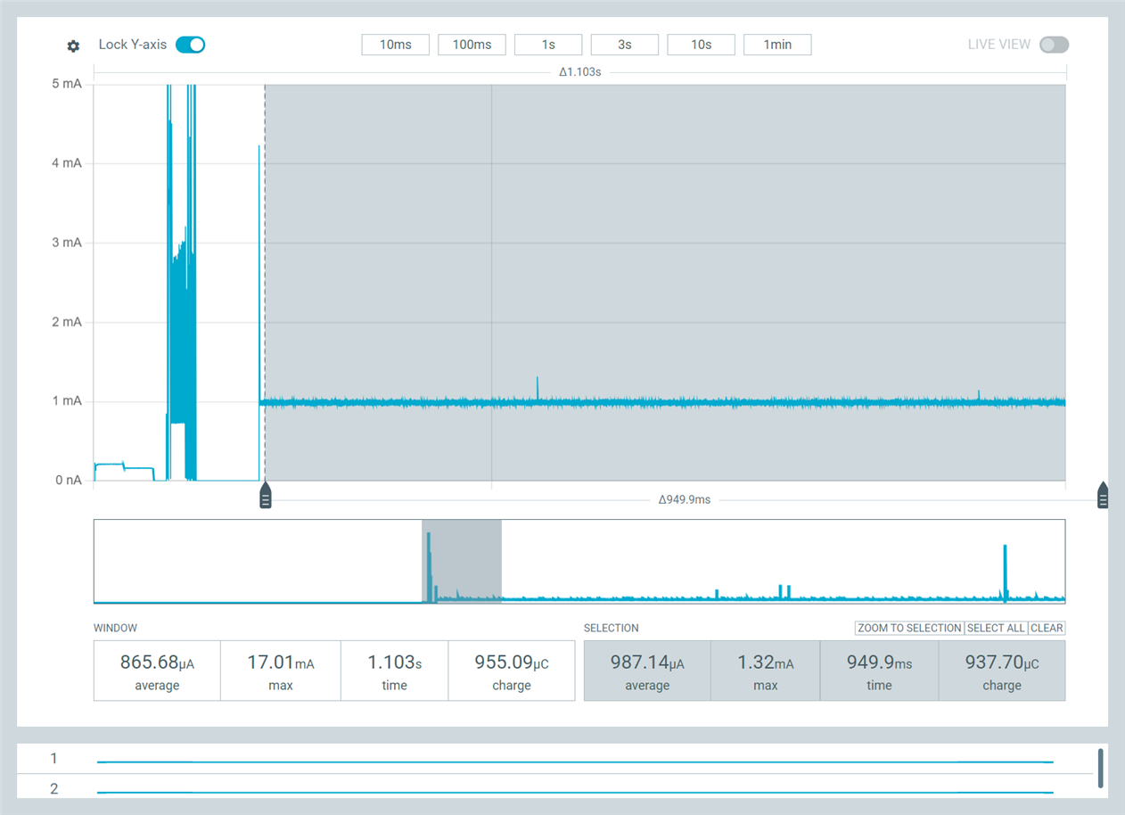

    I also see smaller differences when using ampere mode:
    As compared to source meter:
    I believe the direct reason why you are seeing a difference in the dynamic measurement is due to LDO vs. DCDC. Try disabling the DCDC:
    &reg {
    	regulator-initial-mode = <NRF5X_REG_MODE_LDO>;
    Then the ampere mode will look like this due to less dynamic current consumption (but higher overall current consumption..) draw from the chip:

  • Håkon,
    Thank you again for your help on this. I wanted to close the loop on it.
    We did a comparison of nRF5211 registers settings between the nRF5 SDK and the Zephyr version and were able to source of the difference in behavior, which was due to a few things:
    • First, the difference in behavior was caused by a code error on the nRF5 SDK version of the code, which was that although we were enabling the DCDC regulator, we were doing so incorrectly (that call was accidentally getting made _before_ the SoftDevice had been inited). With the DCDC regulator enabled, we were seeing the same high, spikey power consumption on nRF5 SDK that we were seieng on Zephyr.
    • Of course, power consumption with DCDC enabled will be more spikey, but should be lower. We think the magnitude of the spikes and therefore the higher power consumption were due entirely auto-ranging artifacts on the nRF5 SDK. When we applied caps to the board, obviously the power spikes went away but also the power consumption ended up being lower than we DCDC disabled, as expected.
    So we're all good here.
