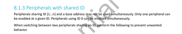

we were using PDK/DK for our development and we got the datasheet "nRF54LM20A_Preliminary_Datasheet_v0.5.pdf"

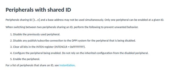

Here it was mentioning about possibility to use shared peripherals of instances 00.
Essentially we wanted to use dedicated pins on for Port 2 for SPIM00 and UARTE00 and designed our board.
Now when we check the latest datasheet online we don't see this line about possibility of using peripherals of 00 ID
With our boards designed, is it possible to use SPIM00 and UARTE00 simultaneously in someway?
