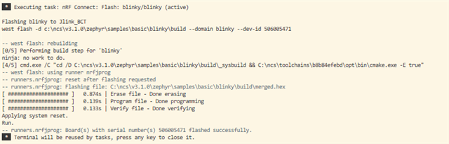

nRF Connect for VS Code: code suddenly stopped executing. Build, flash, verify successful
I've been developing an nRF52840 on a custom PCB for ~1 month now, and my environment was working previously. After updating my version of Jlink and installing other python VS code extensions, code that was once building, flashing, and running successfully now will build, flash, and verify, but will never run. No RTT, uart serial, or GPIO are functioning on the board and I can't get any configuration or environment changes to fix the problem.
I have gone back to attempting to build and run the blinky example (using a GPIO that I can easily measure on my board) so that I can get the code to run and execute main at all.
When I do this, I still get the same successful building and flashing but the code seems to never reach main.

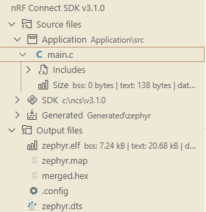

I have noticed that under my build outputs, I see the following:
I have a project for another target that compiles & runs successfully, and i noticed that under main.c, the size (bss, text, and data) were much larger and none were 0. the size of zephyr.elf seems much more appropriate - but when I hit flash it flashes using the file merged.hex.
I was wondering if anyone could shed light on why main.c would be so small (it seems like parts of zephyr or my program are not linking) and the difference between flashing zephyr.elf and merged.hex.

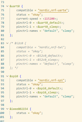

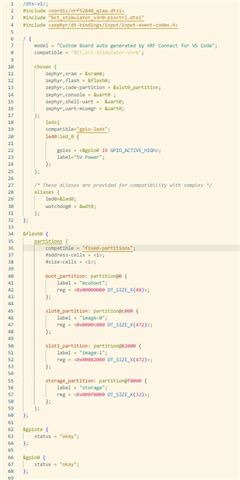

custom_board.dts: (2 images)

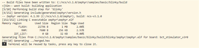

Build output:
Flash output:

    Q1: If you enter debug mode, is the firmware stuck somewhere?
    Q2: Does your custom design have DCDC inductor in-place, and/or an external 32k oscillator in place?
    If not, please add this to your overlay to disable DCDC:
    &reg1 {
    	regulator-initial-mode = <NRF5X_REG_MODE_LDO>;
    and enable internal 32k RC oscillator:
    Håkon
  • Thank you so much for the response!
    1) In debug mode, it does pause in reset.S in this function:
    movs.n r0, #0
    2) There is no DCDC inductor in place between DEC4 and DCC - DCC is floating and DEC 4 is connected to ground through a 1uF cap. There IS an external 32 MHz oscillator connected between XC1 and XC2
    I just attempted a build where I added
    &reg1 {
    to the device overlay to disable the DC/DC converter and there was no difference in program operation or in the debug pause.
    Is there any way to verify that the regulator is actually being disabled in the build? And would that prevent my files from linking properly?

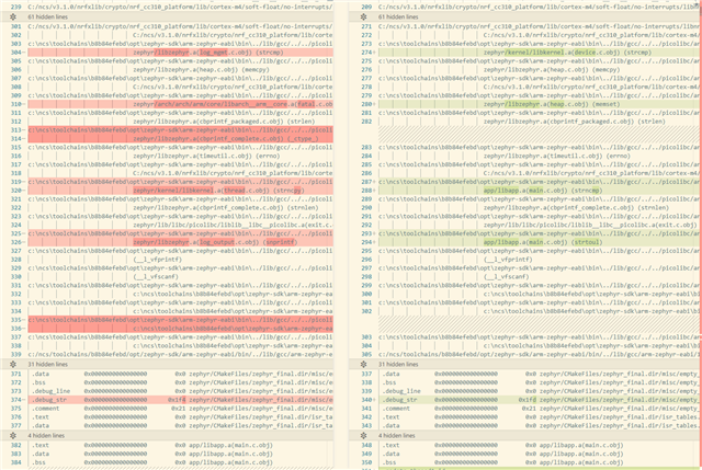

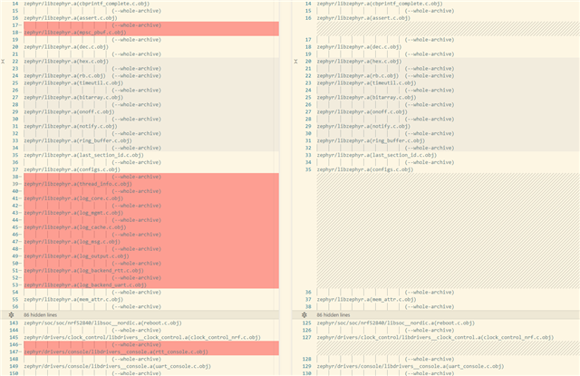

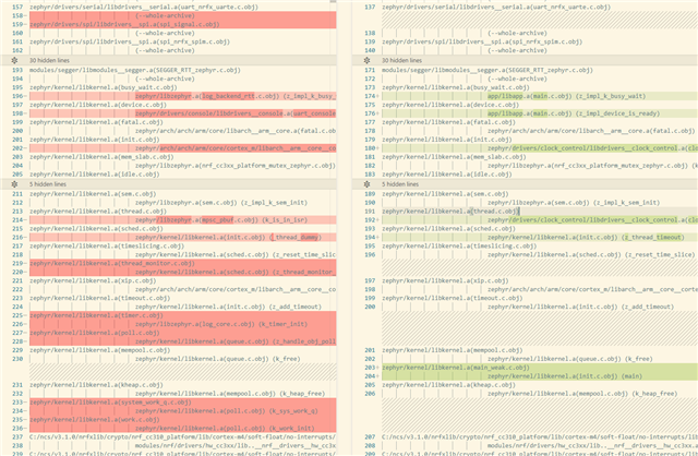

  • Something else that might be of note - for the original project files (not the barebones led example I was attempting to run) my zephyr.map and zephyr_final.map are missing several libraries). It looks like lots of files aren't being linked - from timers, to log libraries, to clock libraries differing.
    These are just a few screenshots of the diff between his working zephyr_final.map (left) and my failing projects' zephyr_final.map (right)
    Our prj.conf should be exactly the same, we are using the same version of Zephyr (3.1.0 for SDK and toolchain) and the same main.c
    Apologies if I'm barking up the wrong tree here.
    Amanda
  • Hi Amanda,
    Hard to state what differs, but the images show that one project has logging enabled, and the other seems to have it disabled.
