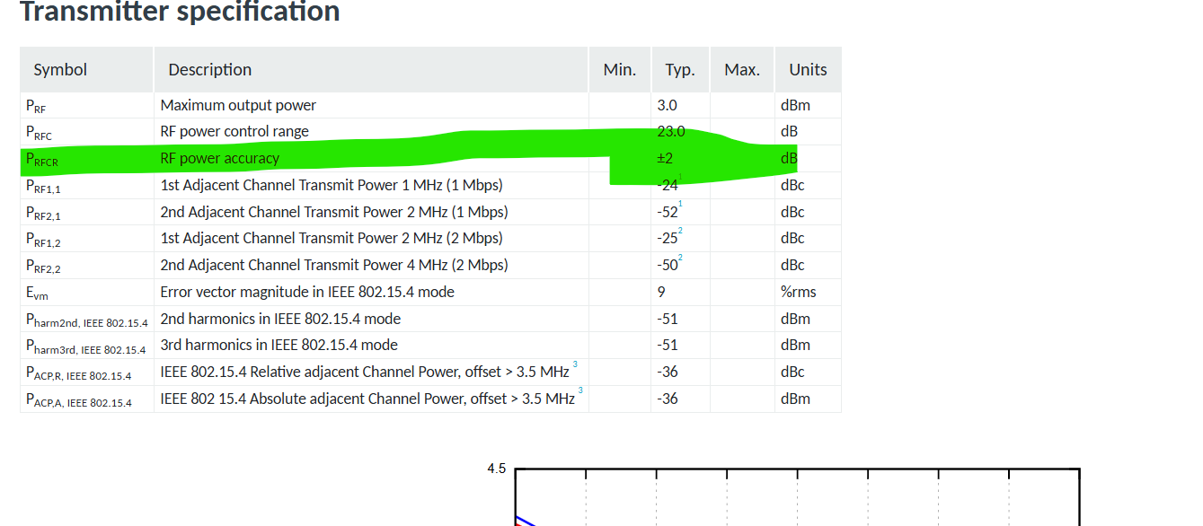

nRF5340: Do you need to configure with high voltage mode to get +3 dBm power?
It isn't clear from the nRF5340 documentation and the only related post doesn't answer it but if we want +3 dBm output power, do we need to wire the nRF5340 in high voltage mode or is normal voltage mode sufficient?

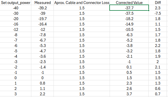

Why I ask is we have a device in EMC/EMI preliminary tests at a lab and when they look at the output power, it doesn't seem to get up to +3 dBm at the end of a 1 m SMA cable (see 1.65 dBm) so a 1.35 dBm loss. At lower power modes below 0 dBm, we see less than 0.5 dBm.
