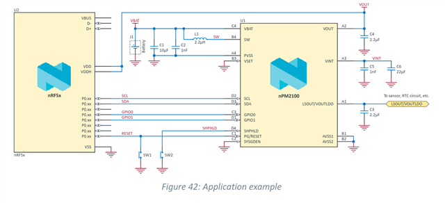

Recommendation for RESET Pin Connections for nPM2100 with nRF54L15
I plan on using the nPM2100 to power the nRF54L15. I'd like to confirm any recommended practices for using the reset pin of the nPM2100.
  1. nPM2100 PG/RESET to nRF54L15 nRESET Connection
    Do you recommend connecting the PG/RESET pin directly to the nRESET pin on the nRF54L15 in typical designs? I understand the PG/RESET pin has multiple functions. I suppose in this arrangement it'd mainly be used for the hard reset functionality and the watchdog timeout functionality.
  2. Capacitor on nRF54L15 nRESET Pin
    If I do connect the pins, are there any concerns with placing a small capacitor, say 10nF, on the nRESET line? I've typically done this for my nRF52832 designs.
