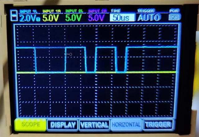

My UART config params look correct in my Zephyr C code and I am not getting an error when I call uart_configure. And yet the evidence would suggest that the configuration is not being set as requested. The transmitting nRF52840 and receiving Pi are presumably not using the same parameters which is why the Pi reports nonsense results.
Note that this Pi has been used for MIDI applications many times before and is therefore a reliable, known quantity. My validation test also verifies that the problem is not at the receiver end of the communication.
Could someone please help with this? Is this a Zephyr bug? Or is it my code?

    I'm now seeing data arriving at the receiving Raspberry Pi but I'm back to square one with many times more bytes received than are sent and nonsense values. This still looks like a mismatch between the transmitter and receiver config to me. I'm not sure what else it could be.
    FYI I only see data arriving when the Adafruit board transmits. So what I'm seeing isn't random noise. Here are the results.

  • It's definitely transmitting which I suppose is something. I have a simple oscilloscope and see activity as transmission is taking place as indicated by console messages. It seems it *must* be the serial config that is the problem.
