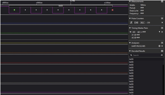

I have an Adafruit Feather nRF52840 which I'm trying to use to transmit data over a UART serial connection to a Raspberry Pi. The Raspberry Pi is running a Python test script (details below) which configures its serial port per the MIDI specification which says:
"The hardware MIDI interface operates at 31.25 (+/- 1%) Kbaud, asynchronous, with a start bit, 8 data bits (D0 to D7), and a stop bit. This makes a total of 10 bits for a period of 320 microseconds per serial byte. The start bit is a logical 0 (current on) and the stop bit is a logical 1 (current off)".
My Zephyr code configures the nRF52840 in the same way. I then send 8 bytes with known values. The Raspberry Pi script prints what it receives to the console.
The Pi is printing 5 times more bytes than are being transmitted and the byte values bear no resemblance to those that were transmitted. I believe this is indicative of a mismatch between the UART configs on the transmitting nRF52840 and the Pi.

My UART config params look correct in my Zephyr C code and I am not getting an error when I call uart_configure. And yet the evidence would suggest that the configuration is not being set as requested. The transmitting nRF52840 and receiving Pi are presumably not using the same parameters which is why the Pi reports nonsense results.
Note that this Pi has been used for MIDI applications many times before and is therefore a reliable, known quantity. My validation test also verifies that the problem is not at the receiver end of the communication.
Could someone please help with this? Is this a Zephyr bug? Or is it my code?
Thanks in anticipation
  • Looking at the file zephyr/boards/adafruit/feather_nrf52840/adafruit_feather_nrf52840.dts on the Adafruit Feather nRF52840, the only pinned UART is uart0 on NRF_PSEL(UART_TX, 0, 25) and NRF_PSEL(UART_RX, 0, 24). I think the uart1 is not routed to the header, so in your overlay you ended up configuring a UART that isn’t actually connected to your wires. That most likely is giving you the garbage at 5x the expected length just because the PI is sampling noise, nothing else.
    use uart0 instead of uart1 and see if you see the same issue. Route the logs to the RTT instead of uart0 so that uart0 is available to your use

  • Hi Susheel, thanks for looking into this. I think you're right in that uart0 should be used. I switched to uart1 after seeing one of your colleagues use it in a previous support request. See  RE: UART config rejected with error -134
    But I now realise they were probably using a different board.
    I also see the DeviceTree view in VS Code showing this quite clearly:
    I've changed my code and included the config properties you recommended but unfortunately I'm now seeing nothing received at all. I've checked connections and see no issue at the hardware level at this stage and it was working before.

  • Thanks Susheel.
    Good news and bad (more accurately, *embarrassing* news!). I have this working now and the problem (sorry guys), was the Raspberry Pi end of things, as was suggested by Susheel some days ago.
    My new logic analyser did a great job confirming that the nRF52840 was working correctly, per the configured UART config.In the trace below, you see a series of 0x55 values correctly decoded from the capture and this is the alternating binary pattern of 01010101 that I was using for testing.
    This led to a closer examination of the Pi which as I said previously, has worked fine with 31250 baud rate MIDI equipment in the past. The issue was that the Pi does not support 31250 as a standard baud rate and so the UART clock is configured in some Linux start-up params (init_uart_clock=2441406) so that a specified baud rate of 38400 actually gives you 31250. My other "working" code was using this but the 38400 requested baud rate was hidden inside an API so that I hadn't realised this trick was in use.
    I learned a lot and want to thank you both for your patience and support. Apologies again if you feel I wasted your time.
