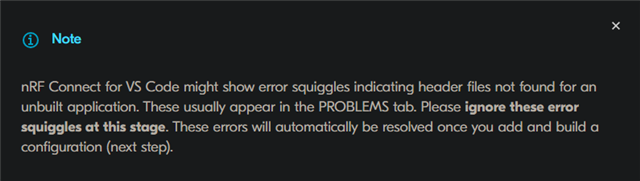

  • Here's the link to the lesson that I'm using: https://academy.nordicsemi.com/courses/nrf-connect-sdk-fundamentals/lessons/lesson-1-nrf-connect-sdk-introduction/topic/exercise-2-1/
    Specifically, this blurb says they should go away:

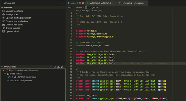

    Here's a screenshot of my workspace:

    It's not that I'm having a problem right now, but when working on projects, I need to be able to look through the full source code when I'm debugging issues. I need to be able to see what these kernel function calls are doing if my program is not behaving as expected. Again, I don't have a problem right now, everything compiles and works fine, but I have always needed to look through files like this during the course of my work.

  • This issue is present in other samples as well.
    Can you elaborate on this? Is there an action on your side that you would want to do but cannot do due to these error squiggles?
    I would like to view the source code of kernel function calls, but I cannot because VS Code Intellisense cannot find the headers/source files. For example, I want to see the code that is executed when the `gpio_is_ready_dt` function is called, but I cannot see the source code due to the error squiggles.
