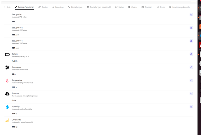

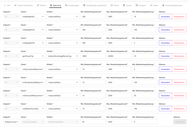

I use Zigbee2MQTT for the Zigbee network, and I get a configuration error when starting the service. The Zigbee2MQTT team told me that this issue is firmware-based. You can see the ticket for this problem here:
https://github.com/Koenkk/zigbee-herdsman-converters/issues/10831#issuecomment-3568319658

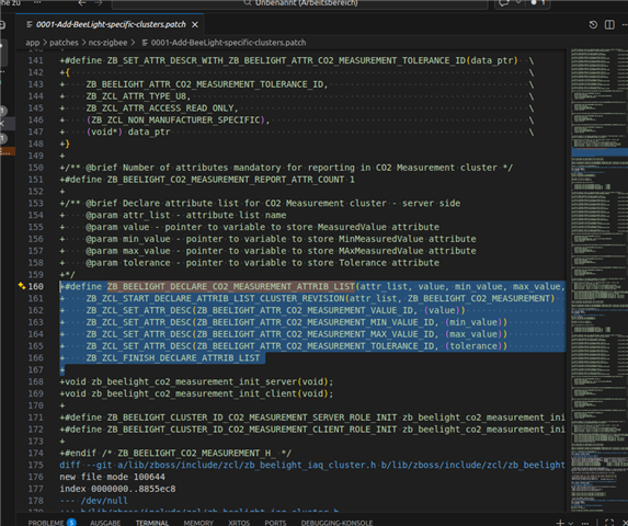

I don´t understand why this issue is related to the VOC cluster only, because the cluster looks basically the same. But I don´t have a deep understanding of ZBOSS and the underlying mechanism, so I need some help to understand the issue and a potential solution. The complete VOC cluster looks like this

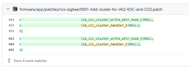

/** @brief Number of attributes mandatory for reporting in BeeLight VOC Measurement cluster */
#define ZB_ZCL_BEELIGHT_VOC_MEASUREMENT_REPORT_ATTR_COUNT 1
/** @brief Declare attribute list for BeeLight VOC Measurement cluster - server side
    @param attr_list - attribute list name
    @param value - pointer to variable to store MeasuredValue attribute
    @param min_value - pointer to variable to store MinMeasuredValue attribute
    @param max_value - pointer to variable to store MAxMeasuredValue attribute
    @param tolerance - pointer to variable to store Tolerance attribute
#define ZB_ZCL_DECLARE_BEELIGHT_VOC_MEASUREMENT_ATTRIB_LIST(attr_list, value, min_value, max_value, tolerance)  \
    ZB_ZCL_START_DECLARE_ATTRIB_LIST_CLUSTER_REVISION(attr_list, ZB_ZCL_BEELIGHT_VOC_MEASUREMENT)               \
    ZB_ZCL_SET_ATTR_DESC(ZB_ZCL_ATTR_BEELIGHT_VOC_MEASUREMENT_VALUE_ID, (value))                                \
    ZB_ZCL_SET_ATTR_DESC(ZB_ZCL_ATTR_BEELIGHT_VOC_MEASUREMENT_MIN_VALUE_ID, (min_value))                        \
    ZB_ZCL_SET_ATTR_DESC(ZB_ZCL_ATTR_BEELIGHT_VOC_MEASUREMENT_MAX_VALUE_ID, (max_value))                        \
    ZB_ZCL_SET_ATTR_DESC(ZB_ZCL_ATTR_BEELIGHT_VOC_MEASUREMENT_TOLERANCE_ID, (tolerance))                        \
    ZB_ZCL_FINISH_DECLARE_ATTRIB_LIST
void zb_zcl_beelight_voc_measurement_init_server(void);
void zb_zcl_beelight_voc_measurement_init_client(void);
#define ZB_ZCL_CLUSTER_ID_BEELIGHT_VOC_MEASUREMENT_SERVER_ROLE_INIT zb_zcl_beelight_voc_measurement_init_server
#define ZB_ZCL_CLUSTER_ID_BEELIGHT_VOC_MEASUREMENT_CLIENT_ROLE_INIT zb_zcl_beelight_voc_measurement_init_client
#endif /* ZB_ZCL_BEELIGHT_VOC_MEASUREMENT_H_ */

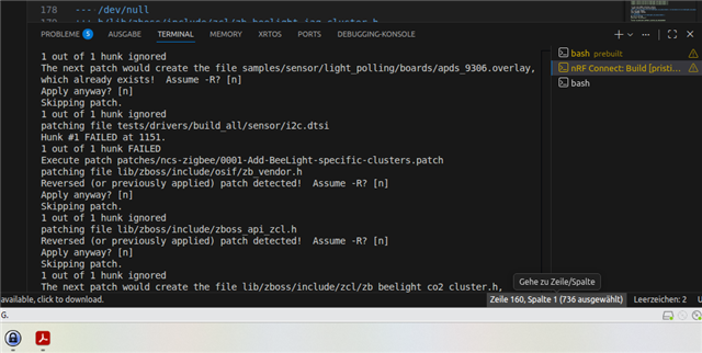

  • Hi Edvin,
    it´s a custom hardware with an nRF54L15 module and I have RTT logging available. I´m using NCS v2.9.2 with ncs-zigbee main.
    https://github.com/Kampi/BeeLight/blob/2.1_Dev/firmware/app/west.yml
    The error message from Z2M is the following
    [2025-11-23 13:10:04] error:    z2m: Failed to configure '0x86d79ac5bae41fa3', attempt 4 (Error: ZCL command 0x86d79ac5bae41fa3/10 msBeelightVOC.configReport([{"minimumReportInterval":300,"maximumReportInterval":3600,"reportableChange":5,"attribute":"measuredValue"}], {"timeout":10000,"disableResponse":false,"disableRecovery":false,"disableDefaultResponse":true,"direction":0,"reservedBits":0,"writeUndiv":false}) failed (Status 'FAILURE')

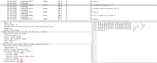

    Can you please try to capture a sniffer trace of the transaction? For this you can use the nRF Sniffer for 802154. You may need to get hold of your network key, but I believe you can find that in your configurations.yaml file in the zigbee2mqtt folder, or it is set to the default HA Z2M network key (I am not certain about this, but I tried reading up on it).
    Also, can you try to adjust your Z2M configuration to see if there is something that your device doesn't accept? e.g. the min/max report interval? Are they too high or low? Also, are there some clusters it doesn't find? What happens if you only try to subscribe to one of them?
    Edvin
  • Hi
    yeah I can give it a try. I´ve done it in the past and I have the equipment for it. I try to do it this or next week because I have to prepare everything :)
    All other Clusters (except VOC) are working fine. The values get reported periodically and also the report intervals are looking correct.

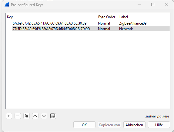

  • Hi  ,
    I´ve made some experiments. My Zigbee network uses the following key
      network_key:
        - 119

    And I´ve configured Wireshark like this (based on this guide here:https://docs.nordicsemi.com/bundle/ug_sniffer_802154/page/UG/sniffer_802154/configuring_sniffer_802154_zigbee.html):
    I configured the device address to "86D79AC5BAE41F11" via the Zigbee config in the firmware and captured the traffic.
    Zigbee.pcapng
    I let the device join the network (address 0xF234), then I tried to read the VOC and humidity cluster via the Zigbee2MQTT developer console. Zigbee2MQTT outputs this, so the configuration of the cluster has failed again. But the read was successful, as I can see a value in the Zigbee2MQTT WebUI. But (without testing) I would assume that the report doesn´t work because the configuration failed, so the value won´t be updated anymore.
    Dec 07 10:04:40 iot node[980]: [2025-12-07 10:04:40] error:         z2m: Failed to configure '0x86d79ac5bae41fa3', attempt 3 (Error: ZCL command 0x86d79ac5bae41fa3/10 msBeelightVOC.configReport([{"minimumReportInterval":300,"maximumReportInterval":3600,"reportableChange":5,"attribute":"measuredValue"}], {"timeout":10000,"disableResponse":false,"disableRecovery":false,"disableDefaultResponse":true,"direction":0,"reservedBits":0,"writeUndiv":false}) failed (Status 'FAILURE')
    Dec 07 10:04:40 iot node[980]:     at Endpoint.checkStatus (/opt/zigbee2mqtt/node_modules/.pnpm/[email protected]/node_modules/zigbee-herdsman/src/controller/model/endpoint.ts:385:28)
    Dec 07 10:04:40 iot node[980]:     at Endpoint.zclCommand (/opt/zigbee2mqtt/node_modules/.pnpm/[email protected]/node_modules/zigbee-herdsman/src/controller/model/endpoint.ts:1055:26)
    Dec 07 10:04:40 iot node[980]:     at Endpoint.configureReporting (/opt/zigbee2mqtt/node_modules/.pnpm/[email protected]/node_modules/zigbee-herdsman/src/controller/model/endpoint.ts:768:9)
    Dec 07 10:04:40 iot node[980]:     at setupAttributes (/opt/zigbee2mqtt/node_modules/.pnpm/[email protected]/node_modules/zigbee-herdsman-converters/dist/lib/modernExtend.js:195:17)
    Dec 07 10:04:40 iot node[980]:     at configure (/opt/zigbee2mqtt/node_modules/.pnpm/[email protected]/node_modules/zigbee-herdsman-converters/src/lib/modernExtend.ts:248:16)
    Dec 07 10:04:40 iot node[980]:     at Object.configure (/opt/zigbee2mqtt/node_modules/.pnpm/[email protected]/node_modules/zigbee-herdsman-converters/src/index.ts:366:21)
    Dec 07 10:04:40 iot node[980]:     at Configure.configure (/opt/zigbee2mqtt/lib/extension/configure.ts:123:13)
    Dec 07 10:04:40 iot node[980]:     at EventEmitter.wrappedCallback (/opt/zigbee2mqtt/lib/eventBus.ts:252:17))
