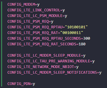

The following image shows the lines added to the base kconfig file:

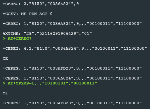

After the device connects, the modem accepts the Active Time, but the TAU timer shows as “Deactivated.”
This happens in the cereg and XMONITOR AT commands

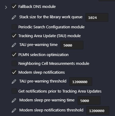

In the nRF Kconfig GUI, I noticed another “Enable PSM” option under the Sierra Wireless HL7800 modem driver. My project does not use that modem, but I tried enabling it anyway. As expected, the build fails if I activate any options related to that driver, so this option is ruled out.

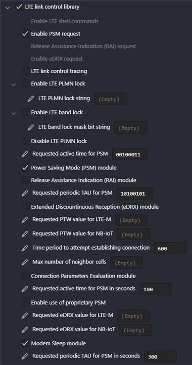

I’ve attached a screenshot of the "LTE Link Control Library" options in nRF Kconfig GUI for reference.

CONFIG_SLM_CUSTOMER_VERSION=""
CONFIG_SLM_EXTERNAL_XTAL=n
CONFIG_MODEM=y
CONFIG_LTE_LINK_CONTROL=y
CONFIG_LTE_LC_PSM_MODULE=y
CONFIG_LTE_PSM_REQ=y
CONFIG_LTE_PSM_REQ_RPTAU="10100101"
CONFIG_LTE_PSM_REQ_RAT="00100011"
CONFIG_LTE_PSM_REQ_RPTAU_SECONDS=300
CONFIG_LTE_PSM_REQ_RAT_SECONDS=180
CONFIG_LTE_LC_MODEM_SLEEP_MODULE=y
CONFIG_LTE_LC_TAU_PRE_WARNING_MODULE=y
CONFIG_LTE_NETWORK_MODE_NBIOT=y
CONFIG_LTE_LC_MODEM_SLEEP_NOTIFICATIONS=y
CONFIG_PDN=y

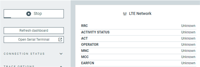

    Regarding another topic, I have questions about how to obtain modem traces. My assumption is that this is typically done through the Cellular Monitor application. However, when connecting the device, the interface fails to interpret the modem responses, resulting in all fields being displayed as “Unknown.”
    Attempts to capture traces under these conditions have produced files with a size of 0.

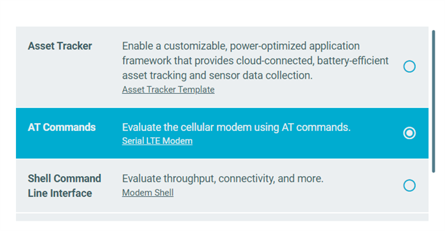

    The only method I have found to successfully obtain traces is by using the pre-installed firmware that is deployed when selecting the AT commands option in the Quick Start menu. Unfortunately, this firmware does not include the PSM-related configurations mentioned earlier in the discussion.
