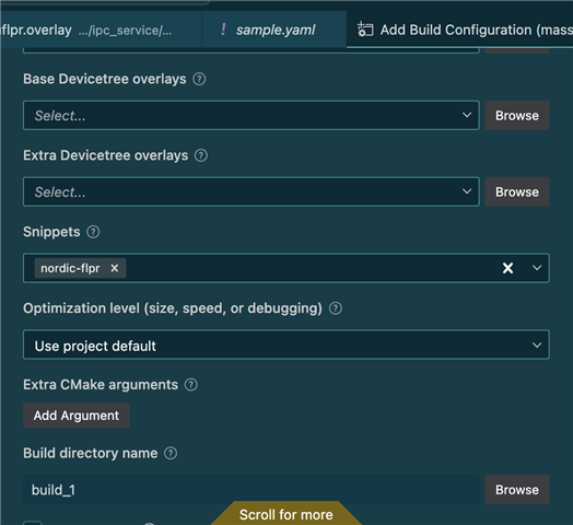

    Q1: Are you building with the "SNIPPET=nordic-flpr" in place?
    ie. west build -b nrf54l15dk/nrf54l15/cpuapp -- -DSNIPPET=nordic-flpr
    or in vscode:
    Q2: Have you checked out the IPC sample, specifically with how the "remote" example is pulled in?

    We know that both cpuapp and cpuflpr are running, since we have RTT logging from cpuapp and serial logging from cpuflpr. In fact, we know the exact spot where cpuapp halts, which is on the line in our program corresponding to  ` k_sem_take(&bound_sem, K_FOREVER);` in `zephyr/samples/subsys/ipc/ipc_service/icmsg/src/main.c`. It halts here because the callback `ipc_ept_cfg.cb.bound` is never called by the IPC library.
    To answer your questions:
    A1: We do not directly use the nordic-flpr snippet. What we have done is copy the contents of the snippet and changed some of the values, since we have allocated more SRAM to FLPR than the default. This all works fine until we have both bluetooth mesh and ipc enabled in the config. This means we are using sysbuild and have added the relevant overlay code.
    A2: We based our IPC on the icmsg sample in zephyr (not sdk-nrf) because it had overlay and config files for nRF54L15. Looking at a diff between the two samples, I can't see any relevant differences which could impact our program. We already use the following in our project, which works fine:
