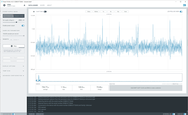

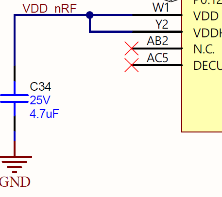

Cannot achieve low-power on nRF52833 custom PCB using simplest main() yields 740uAmps
Chip : nRF52833 QIAA
Environment : Visual Code + nRF Connect for VC Code V2025.8.654 NCS V3.1.0
I am hoping somebody could assist us with a problem we are having achieving the expected low current operation on the nRF52833 soc on a custom PCB in sys_poweroff()  (and also in k_sleep())
In an attempt to narrow this down have depopulated the PCB to contain just the nRF52833 SOC all the other passives and bus peripherals are de-soldered.

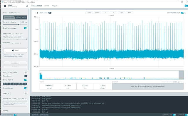

I have created a simple application which does nothing other than to set all GPIO as inputs and enter k_sleep () and the current is measured using PPK2 at ~750uAmps. There is spiking activity
It feels like I have read every article on this subject from here and the suggested sample such as \ncs\v3.1.0\zephyr\samples\boards\nordic\system_off.   Please can anyone suggest a remedy?

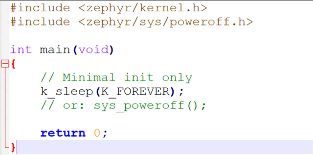

main.c
#include <zephyr/kernel.h>
#include <zephyr/drivers/hwinfo.h>
#include <zephyr/sys/poweroff.h>
#include <hal/nrf_gpio.h>
    for (uint8_t idx = 0; idx < NUMBER_OF_PINS; idx++)
        nrf_gpio_cfg_default(idx); // Input, no pull up/down, no sense
    // k_sleep(K_FOREVER);
    hwinfo_clear_reset_cause();
    sys_poweroff();
    return 0;
