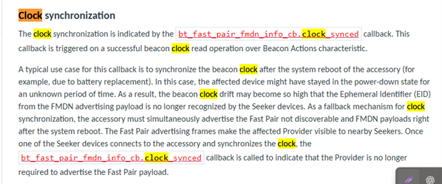

I am working on developing Locator Tag using NCS fast pair sample code. I have one query here. Is Accurate RTC required for Google FMDN locator tag? If device loose its RTC for some reason then is clock syncing required for accurate location tracking?
