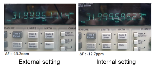

I have some questions regarding the 32 MHz crystal on the nRF54L15:
  1. If my firmware is configured to use external capacitors, will the very first crystal startup waveform captured after power-on already be using the external capacitors? Or is it still using the internal capacitors at that moment?
  2. The reason I’m asking is that I used the same PCB design but tested it with different firmware settings (external vs. internal capacitors). The measured frequency offset did not match my expectations. My external load capacitors are 12 pF, and the internal setting is the default 15 pF. However, the result I observed is that when using only the external capacitors, the frequency offset is actually 2 ppm slower compared to using the internal capacitors in firmware (with the external capacitors still mounted).

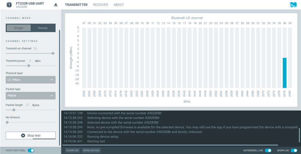

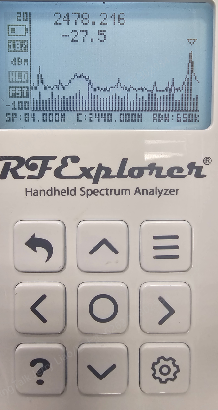

    That is unexpected. A too high frequency indicate too low load capacitor value, and vise versa. How do you measure this? The recommended way to measure is to set up a carrier frequency (I suggest you use the radio test sample) and measure the offset using a signal/spectrum analyzer).

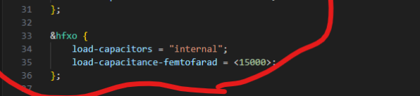

    At startup, the HFINT is used by default, and the HFXO is only started by firmware when an accurate clock is needed. And when the HFXO is started, the configured values for load capacitors are used from the start.
    Which 32MHz crystal are you using? Can you share the datasheet? Also, how does your devicetree where you configure the load capacitors look like?
    For reference using internal, it should look like this which is the default as you write (here with 15 pF, adjust value as needed):
    &hfxo {
    	load-capacitors = "internal";
    	load-capacitance-femtofarad = <15000>;
    Disabling internal can be done like this:

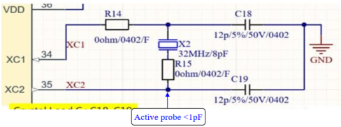

    1. Our test setup uses a frequency counter (Agilent 53131A) and an active probe (Tektronix P6243) to measure the crystal frequency. The firmware we are using is based on nRF Connect SDK v3.0.0 – direct_test_mode, with the only modification being the setting to use either the external capacitor or the internal capacitor.
    2. So can I conclude that when I measure the HFXO signal at the C19 node, the load-capacitor configuration is already active at that moment.
    3.  Based on what I found in a forum discussion about capacitor selection, one of the replies mentioned that “the external capacitors are also physically present in parallel with the internal capacitors.”
    Because of this, I assumed that when using the internal 15 pF setting, the internal capacitor would be in parallel with my external 12 pF capacitors, giving a total of around 27 pF.
    Following this logic, when testing on the same PCB (which always has 12 pF external capacitors), the internal-cap setting should give a slower frequency than the external-cap setting.
    However, in our actual measurements, both configurations show almost the same behavior, with an effective load close to 13 pF. This is still within the spec, but it is different from what we expected.
    You can refer to the figure below.
     nRF54L15 crystal load capacitor selection

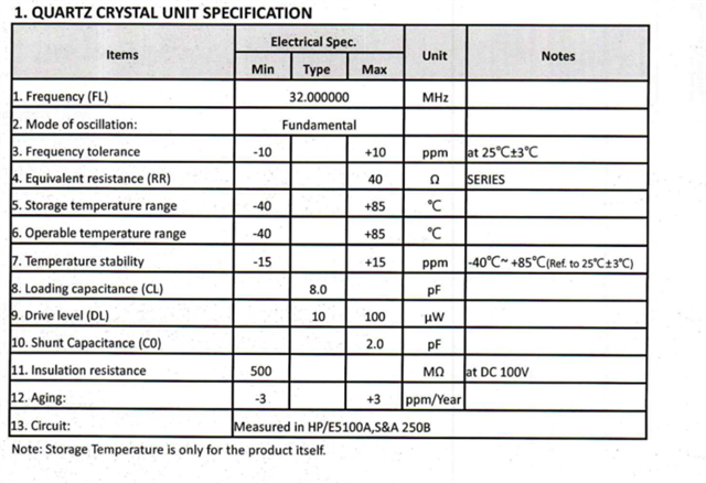

    4. We are using the X2C032000B81H-HS/HELE crystal, and the load capacitors are shown in the schematic above.
    5.I confirmed with our FW engineer that the configuration is the same as the information you provided, as shown below.
    Thank you for confirming, this makes sense. I would suggest that you remove the external load capacitors as they are not needed and use only internal capacitors.
    Your crystal is specified to 8 pF, so twice that minus a bit of trace capacitance results means that 15 pF is probably sensible (so I suspect your external capacitors are a bit too small in any case). I recommend that you test the frequency error/offset with different load cap values to find the optimal value experimentally.
