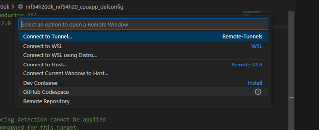

    I would say the easiest way to install NCS in WSL is to use VScode
    Press CTRL+Shift+o to open the following menu
    Then connect to wsl and proceed to install NCS as you would in windows by installing the correct extensions and downloading the sdk
    When you have done this, you can continue to develop as normally only difference is that you are using windows.
