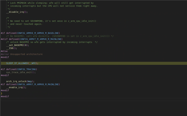

Using the debugger, I found that the code hangs at line 141 in zephyr/arch/arm/core/cortex_m/cpu_idle.c at the SLEEP_IF_ALLOWED(__WFE) instruction inside arch_cpu_atomic_idle().
It appears the system enters idle mode but never wakes up.

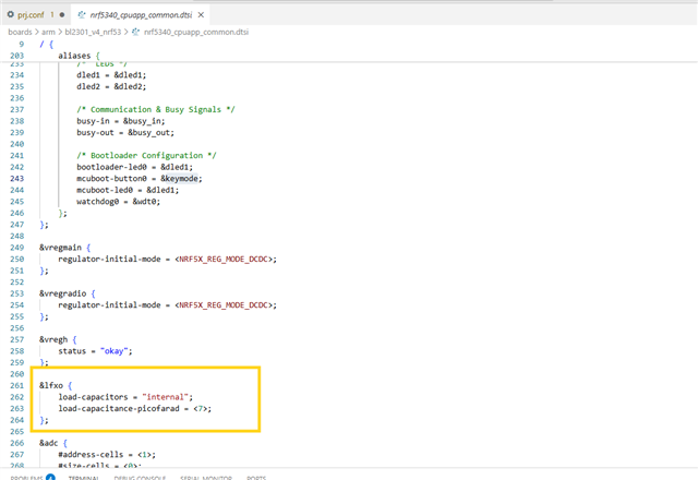

    I found the following LFXO configuration in my device tree file. Could this be causing the issue?
    Additionally, I checked the generated build/zephyr.dts and found this output for the clock controller...

    Since my custom board does not have an external 32.768 kHz crystal, should I disable the LFXO node in my device tree overlay like this?
    &lfxo {
        status = "disabled";
    Would this resolve the hang at SLEEP_IF_ALLOWED(__WFE) that I'm experiencing?
    Yes.
