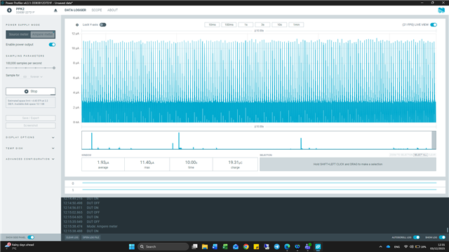

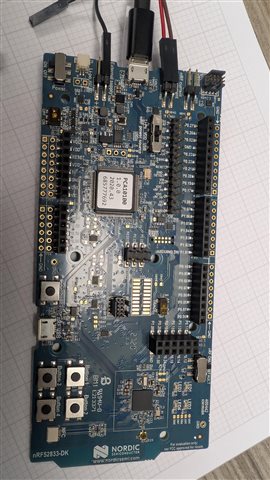

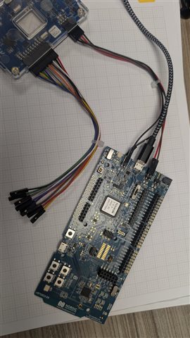

  • In the absence of any further reply from Swathy, I thought others may find this useful as we worked it out for ourselves.
    Connect the PPK II to the DK as shown in the image:
    1- From P1 on the PPK II:
       Black → GND
       Brown → P22 (VDD_nRF – the pin farthest from the USB connector)
       Red → P22 (VDD_nRF – the pin closest to the USB connector)
    2- Set SW6 to “nRF ONLY”.
    3- Leave SW9 in the middle position (VDD on-board).
    4- Leave SW10 in the off position.
    5- Power the board by connecting a USB cable.
    6-In the Power Profiler app, set the device to Ammeter mode, enable, and press Start to begin measuring current.
