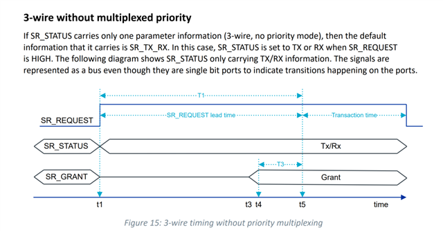

in our 7002 document, there is a Figure 15 as below:
is this figure correct? if it is correct, the request lead time T1 covers the Grant timing, than request pin can be used as antenna control, right?

  • thanks Asbjorn,
    the key point is if time costs for request will cover the time of grant, i am not sure of this.

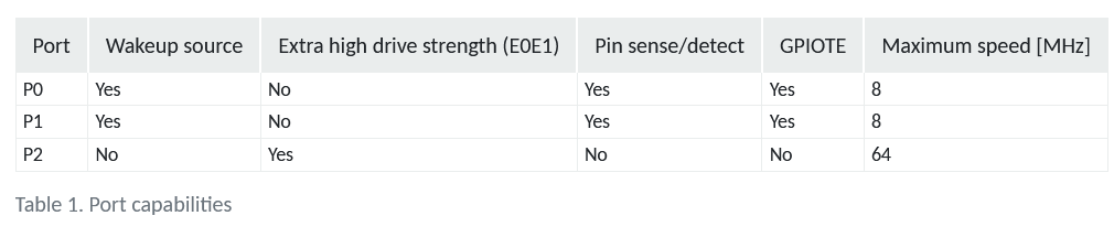

    another question is coex pins must using P0 and P1,right, P2 doesn't have GPIOTE in 54L15. or for 3 wires coex, which pin can use P2 port, whch pin can't use P2 port?
    William.
  • Hello William,
    You can't use P2 for the pins. P0 or P1 have to be used for the gpio based coex interface.

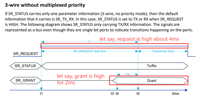

  • i mean
    1.  is the timing sequence correct in this figure?
    requst pin will be held for such a long time?
    if there is a docs about the details of our PTA?
    2.  all these three pins should not use P2? which pin is gpio not gpiote?

  • Hello William
    Q1:
    General description:
    The timing isn't standard as it will depend on the product and traffic. So the request lead time will depend on the WiFi chip they are using. Are they sure it's a good idea to switch the roles around and deviate from having the WiFi control the antenna? How have they tried to debug the grant pin not asserted on the WiFi chip? It's a standard interface and should respond to the request. The wifi chip is the one that grants antenna access, so it should control the grant pin as needed and respond to the BLE requests. It sounds like the WiFI TX is working, but the WiFi RX isn't working as the BLE is granted access to the antenna when the WiFI is supposed to do RX?  Does the BLE functionality work as expected?
    Q2:
    All GPIOs starting with P2. is on port 2.
