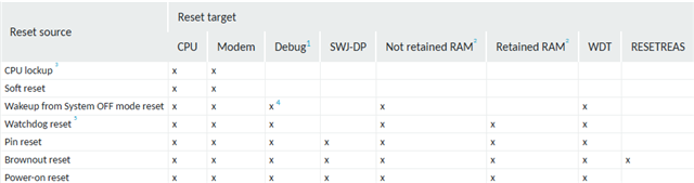

We have a small number of returns for our product, where the modem has gotten into some sort of strange state, and almost seems like it is unresponsive, or blocked from connecting to any network. It's very difficult to debug as most of them have been out in the field for months, if not years, before it happens. I wouldn't be surprised if it was some sort of Cell tower upgrade that messed up a live connection or something. When researching, I thought it might be the Modem Reset Loop Restriction, but after forcing that issue, it does recover eventually, so I am not sure that is it. I will continue to look for the real issue behind what this state even is, but until I find that, I need a failsafe to getting it out of this state. A soft reboot using the function ;
NVIC_SystemReset();
Does not fix it, but a Pin reset (nRESET line) does fix it. The problem is, we have no way to pull that line down, other than physically opening an IP68 rated enclosure, which we do not allow customers to do, so they have to send the units back for us to do a simple reset. A brown-out also fixes it, but again, customer would have to open the enclosure, remove the battery, AND we have a large supercapacitor which would take time to discharge, so that is not an option.
Looking at the above table made me think it must be something to do with the retained RAM, so I thought I could try forcing a watchdog reset, and test to see if that fixes the issue, BUT we already use a watchdog set to 5 minute expiry. Whatever is going on when it is in this state still manages top feed the watchdog. I tried disabling the watchdog and resetting it up to 5 seconds, and block feeding, but when I try and set a different timeout, it fails. In the Zephyr Docs, in the disable function it states  -

    The main point though, is that I need a way to imitate doing a Pin Reset (holding nRESET line low), in software, I figured WDT reset is probably the closest, unless there is another way?

  • Some designs implement a software-triggered power-on reset by mistake, a feature usually discovered after a few thousand devices are in the field; note this feature is heavily dependent on the power source and current capability of the source. Tie two or more GPIO pins together on the board and first set both (all) outputs low then configure all to High-Drive outputs. When a reset is required at some future time or event set one (or more) pin high, either in software or hardware via PPI from an impossible Event such as timer overflow or (say) push-button input.
    Not a Nordic-supported solution, I should add :-)
    Edit: After re-reading the original post I see this is not an option, but maybe since ram is a suspect set all RAM[].POWER to power down all ram, then without using the stack wait for a large number of CPU cycles then again without using the stack issue a soft reset. Hopefully the ram will have decayed. Other option is to zero all ram without using the stack then issue the soft reset.
