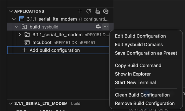

  • OK, I foud thw issue, but I'd like to know a better way of doing this.
    I had to add build configuation, so I'm guessing that build config is in the build directory which wasn't in svn. When I added that I got one detail wrong in the board target.
    I don't understand why that would bork the reset line, but the big question is, why does that even have to be recreated? Surely that should be part of the project. If that is set up and working you should not have to recreate when you transfer to a new machine. So what files from the build directory should ne put into version control? There are SO many of them and I don't want to store unnecessary guff.
    You have for example those two options for exporting the build configuration:
    • Save Configuration as Preset (gives you a JSON output)
    • Copy Build Command
