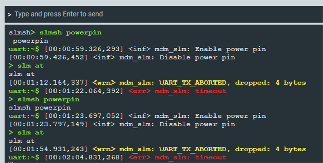

- On the slm-shell, when sending a simple "at" command, I receive TX Abort, I tried increasing the timeout, got same result:
*** Booting nRF Connect SDK v3.1.1-e2a97fe2578a ***
*** Using Zephyr OS v4.1.99-ff8f0c579eeb ***
[00:00:00.320,373] <inf> app: SLM Shell starts on nrf52840dk
[00:00:00.320,434] <inf> mdm_slm: UART baud: 115200 d/p/s-bits: 3/0/1 HWFC: 1
uart:~$ > slm at
slm at
[00:01:23.960,601] <wrn> mdm_slm: UART_TX_ABORTED, dropped: 4 bytes
uart:~$ [00:01:33.860,687] <err> mdm_slm: timeout

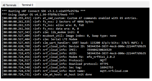

- On the modem side, I am using J-link RTT Viewer, but cannot capture any logs after the initial connection:
[00:00:00.252,655] <err> spi_nor: Device id 90 ca 33 does not match config c8 65 19
[00:00:00.253,662] <inf> at_cmd_custom: Custom AT commands enabled with 64 entries.
[00:00:00.254,119] <dbg> slm: main: RR: 0x00000001
[00:00:00.260,833] <inf> fs_nvs: 2 Sectors of 4096 bytes
[00:00:00.261,169] <inf> fs_nvs: alloc wra: 0, fe8
[00:00:00.261,505] <inf> fs_nvs: data wra: 0, 0
[00:00:00.528,778] <inf> slm: lib_modem init: 0
[00:00:00.529,144] <inf> mcuboot_util: Image index: 0, Swap type: none
[00:00:00.529,510] <inf> slm: Serial LTE Modem
[00:00:00.529,846] <inf> slm_uart_handler: UART baud: 115200 d/p/s-bits: 3/0/1 HWFC: 1
[00:00:00.623,565] <inf> nrf_cloud_info: Device ID: 50344354-3837-4ec6-800e-22144f7d9b35
[00:00:00.629,241] <inf> nrf_cloud_info: IMEI: 359404230026529
[00:00:00.721,588] <inf> nrf_cloud_info: UUID: 50344354-3837-4ec6-800e-22144f7d9b35
[00:00:00.727,569] <inf> nrf_cloud_info: Modem FW: mfw_nrf91x1_2.0.2
[00:00:00.727,966] <inf> nrf_cloud_info: Protocol: MQTT
[00:00:00.728,302] <inf> nrf_cloud_info: Download protocol: HTTPS
[00:00:00.728,668] <inf> nrf_cloud_info: Sec tag: 16842753
[00:00:00.729,034] <inf> nrf_cloud_info: Host name: mqtt.nrfcloud.com
[00:00:00.729,553] <dbg> slm_at_host: slm_at_send_indicate: TX
52 65 61 64 79 0d 0a |Ready..
[00:00:00.730,621] <inf> slm_at_host: at_host init done
    I was able to reproduce this issue. But on my side it turned out to be wrong wiring. Double checked my wires and had flipped rx and tx on one side. Now I can send the command slm at and get response OK. Also, slmsh powerpin works as expected.

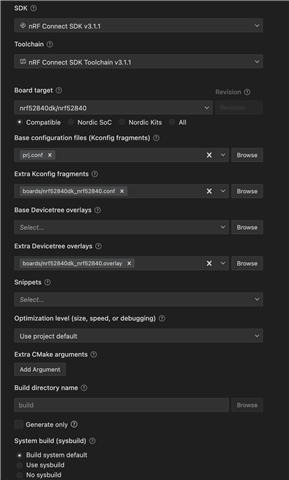

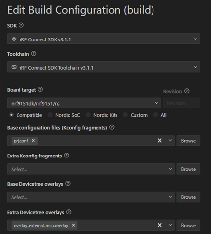

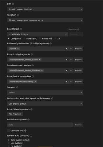

    Here is my build configuration in VS Code for both projects:
    SLM
    SLM Shell

    - As for SLM, I am not receiving the Ready message after toggling the power pin:
    It seems J-link RTT is somehow disconnected, can't figure out the reason.

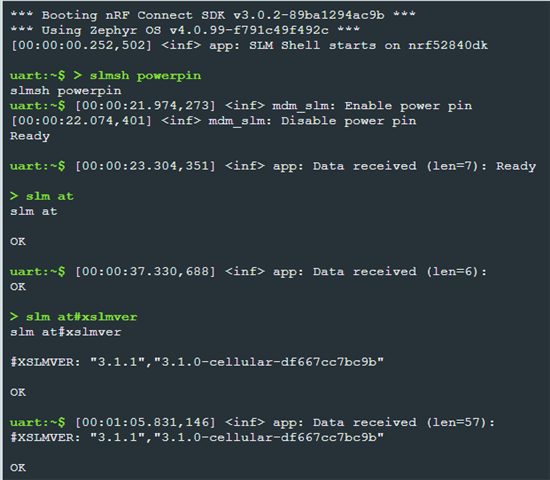

  • Hello Øyvind,
    I re-installed the SDK, toolchain, and SEGGER, running more tests. The SLM-shell seems to work as expected, please see the logs below:
    However, no changes on the RTT viewer, same results as my last post. I tried both J-Link v8.88 and v8.76.
