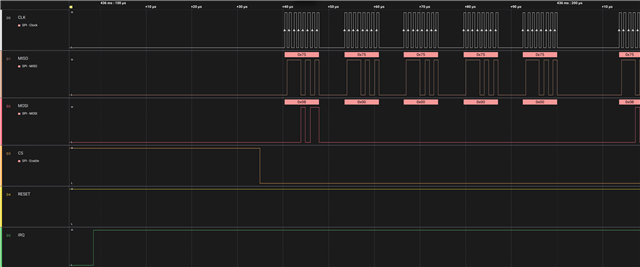

Hello, I'm trying to make samples/bluetooth/hci_spi work on my nRF54L15-DK however I encounter some issues My device tree overlay is as followed:

I know that spi21.def-char should be <0x00> however for my test purpose it helps me to diagnose my SPI connection problem.
I also deleted all SPI devices and all buttons to prevent any conflict with development kit hardware

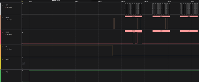

When I try to start the SPI communication with it I get the following when all pins are plugged.
If I unplug CS and plug it directly to ground I get the following result:
What I find strange is that in the case were all pins are plugged the nRF54L15 try to send on MISO data when CS goes data even without any clock.
The first few bytes send by the nRF54L15 should be 04 ff 02 01 00
I also check with an oscilloscope but the signals are very clear.
Additionally I had to set my board on 3.3V as the SPI Master use this voltage.
Is there something I missed ?

    My understanding here is that the slave firmware is doing everything it is supposed to do. The problem is, with the SPI master firmware. It is not finishing the two-phase handshake that the sample code is expecting from the Zephyr HCI-SPI code and our SPI master. The Zephyr HCI-SPI code is waiting for this handshake to be completed by our SPI master.
    In zephyr/samples/bluetooth/hci_spi/src/main.c the controller sends data to the host through spi_send() (lines 103‑148). The TX thread (bt_tx_thread, lines 150‑246) loops forever doing 5‑byte header exchanges with the host. Only when it sees the host issue a READ request (header_master[0] == SPI_READ/0x0B) does it release sem_spi_tx, so that spi_send() can run its own header exchange and then push the payload. The Nordic HCI SPI transport always needs two transactions where the chip select's low, for every single packet of the Nordic Zephyr HCI SPI transport.
    The master asserts CS, clocks out five bytes, and reads the slave header (byte 0 = READY_NOW/0x02, byte 3 = payload length). Once those five bytes are in, CS must go high so the slave can prepare the payload. When the payload is ready the slave raises Interrupt Request. The master then makes Chip Select active again sends a 0x0B which means read on the Master Out Slave In line and clocks out the payload bytes which are 04 ff 02 01 00, for the initialized event. Only after this second transfer happens the slave drops Interrupt Request. Goes back to idle state waiting for the next command.
    When you look at the Saleae captures you see that the master is keeping the Chip Select low. It is sending the bytes 0x0B. Some extra bytes, but it never lets go of the line between the header and the payload. This means the slave gets stuck, in the header state and never moves on. The function spi_send gets stuck in a loop waiting for something to happen. The Interrupt line just stays high. All you see on the MISO line is the header byte, which's either 0x02 or the test character 0x75 repeating over and over. When the Computer System is grounded it makes the Serial Peripheral Interface System peripheral send out the default character all the time. This is what the Serial Peripheral Interface System peripheral should be doing when it is not busy with a request from the Computer System. The Computer System and the Serial Peripheral Interface System peripheral work together, in this way.

    Additionally on the second picture the displayed CS is the output of the host which is not connected to the nRF54, as this is the case were I plug nRF54 CS to ground if I did not properly convey it.
    Also to re-contextualize those screenshots they represent the first exchange after reset which means that on both screenshot the IRQ going high is due to the nRF54 having finished its reset and telling the master that it is ready to receive commands.
    Signals
    Also this does not explain on the first picture why does the MISO seems to start outputting data without any clock on the first picture once CS goes down (which is weird and does not appear if CS stay down which was the second picture), even if in this case it does not seems to cause any issue in the communication.

    After some research I finally figured out why the communication didn't worked...
    I had spi-hold-cs selected for SPI preventing the communication from working.
    This allows to pass the bt_enable however I still got some errors along the way which completely stop the scan.

            Controller unresponsive, command opcode 0x200e timeout with err -11
    [00:00:14.473,000] <err> os: r0/a1:  0x00000003  r1/a2:  0x00000000  r2/a3:  0x00000002
    [00:00:14.473,000] <err> os: r3/a4:  0x00000003 r12/ip:  0x00003889 r14/lr:  0x3418540b
    [00:00:14.473,000] <err> os:  xpsr:  0x01000000
    [00:00:14.473,000] <err> os: Faulting instruction address (r15/pc): 0x3418541a
    [00:00:14.473,000] <err> os: >>> ZEPHYR FATAL ERROR 3: Kernel oops on CPU 0
    [00:00:14.473,000] <err> os: Current thread: 0x3419b550 (sysworkq)
    [00:00:14.511,000] <err> os: Halting system
    [00:00:02.957,000] <err> bt_driver: Unknown BT buf type 117
    [00:00:31.554,000] <err> bt_att: ATT Timeout for device F4:12:FA:86:7B:79 (public). Disconnecting...
    [00:00:31.571,000] <wrn> bt_conn: conn 0x3419a960 failed to establish. RF noise?
    ASSERTION FAIL [err == 0] @ WEST_TOPDIR/zephyr/subsys/bluetooth/host/hci_core.c:504
            Controller unresponsive, command opcode 0x0406 timeout with err -11
    [00:00:41.554,000] <err> os: r0/a1:  0x00000003  r1/a2:  0x00000000  r2/a3:  0x00000002
    [00:00:41.554,000] <err> os: r3/a4:  0x00000003 r12/ip:  0x0000a252 r14/lr:  0x3418540b
    [00:00:41.554,000] <err> os:  xpsr:  0x01000000
    [00:00:41.554,000] <err> os: Faulting instruction address (r15/pc): 0x3418541a
    [00:00:41.554,000] <err> os: >>> ZEPHYR FATAL ERROR 3: Kernel oops on CPU 0
    [00:00:41.554,000] <err> os: Current thread: 0x3419b550 (sysworkq)
    [00:00:41.592,000] <err> os: Halting system
    EDIT2: Thank to all your information I was able to diagnose the underlying issue and I'm finally able to make both cards communicate without any issues.
    I'm really grateful for the time you took to help me,
    Robyn
    Previous Answer:
    I enabled the config flag you mentionned and got
            Controller unresponsive, command opcode 0x2022 timeout with err -11
    [00:00:11.628,000] <err> os: r0/a1:  0x00000003  r1/a2:  0x00000000  r2/a3:  0x00000002
    [00:00:11.628,000] <err> os: r3/a4:  0x00000003 r12/ip:  0x00002d6c r14/lr:  0x34185413
    [00:00:11.628,000] <err> os:  xpsr:  0x01000000
    [00:00:11.628,000] <err> os: Faulting instruction address (r15/pc): 0x34185422
    [00:00:11.628,000] <err> os: >>> ZEPHYR FATAL ERROR 3: Kernel oops on CPU 0
    [00:00:11.628,000] <err> os: Current thread: 0x3419a488 (BT RX WQ)
    [00:00:11.666,000] <err> os: Halting system
    Which seems to make it clear that it is caused by the following warnings that I have
    <wrn> bt_hci_core: opcode 0x2022 status 0x01 BT_HCI_ERR_UNKNOWN_CMD
    EDIT1: After some research I discovered that it was because the BT_HCI_OP_LE_SET_DATA_LEN was not understood but the following configuration was missing on the nRF54 and so the command failed. After fixing the configuratuib the warning disappear.
    CONFIG_BT_DATA_LEN_UPDATE=y
    However some issues still persists after that, I've got the following error followed promptly by different crashes, each time after the following error
    EDIT2: The cause was my debug default char being set to 117 which caused the following issue.
    [00:00:01.531,000] <err> bt_driver: Unknown BT buf type 117
    [00:00:04.491,000] <wrn> bt_conn: conn 0x3419aa30 failed to establish. RF noise?
    [00:00:04.492,000] <wrn> bt_conn: conn 0x3419ab00 failed to establish. RF noise?
