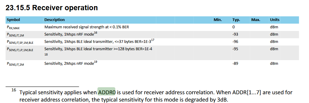

During the transmission and reception performance test, I found that the LE1M's maximum sensitivity was only -92 dBm, while the LE2M's maximum sensitivity was only -89 dBm. These values were measured using the IQ and added pathloss. The data do not match sensitivity of -96dBm in datasheet. Could you please confirm whether the configuration mode for SDK 2.6.1 is nRF mode?

    3. I noticed the following statement in the datasheet:
    'Typical sensitivity applies when ADDR0 is used for receiver address correlation. When ADDR[1...7] are used for receiver address correlation, the typical sensitivity for this mode is degraded by 3dB.'
    Therefore, I request your assistance in verifying whether any errors exist in the register configuration at the software level.
    Best Regard.
    Star.Tong

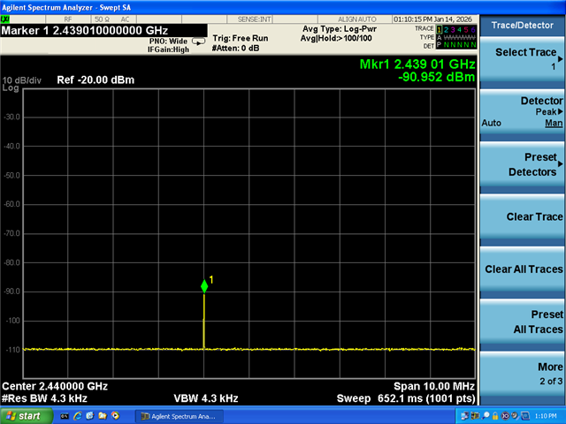

    I ran a SA check today and found that a spur appears at the ANT port when in receive mode, and varies with changes in channel settings.
    What do you think caused this?
    We've encountered similar issues on other chips and resolved them by modifying the firmware. Do you have any recommended solutions?

    with the screen shot I assume you have configured the device to in receive mode 1Mbit at frequency 2440?
    The spur you are observing is the receive local oscillator. It can be seen as RXLO = frequency-1MHz (for 1Mbit mode) and 2xRXLO.

    Correct. I set the mode to LE1M. Is there a solution for this issue?

    The spur you observe is a part of the radio design. https://en.wikipedia.org/wiki/Local_oscillator
    How is this spur an issue for you and what you are working on?
