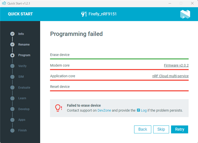

Failed to erase device (nRF9151-DK) when programming via nRF Connect for Desktop
I get the following error when trying to program the device:
The log shows this:

2025-12-10T09:09:05.294Z DEBUG Selected device: nRF9151 DK
2025-12-10T09:09:05.856Z DEBUG Changed step: Info
2025-12-10T09:09:12.013Z DEBUG Changed step: Rename
2025-12-10T09:10:00.777Z DEBUG Changed step: Program
Is there a way to resolve this?

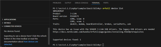

Initially I was already unable to find the device via Visual Studio (with the nrf extensions). It says no devices found in Connected Devices although it does find the device via nrfutil. I get a warning about the legacy USB drivers being missing. I did do the Segger J-Link installation with the legacy USB driver checkbox enabled but for some reason it is unable to find them.
This is the reason I went to the nRF Connect for Desktop application to see if I could at least connect to and program the device from there.

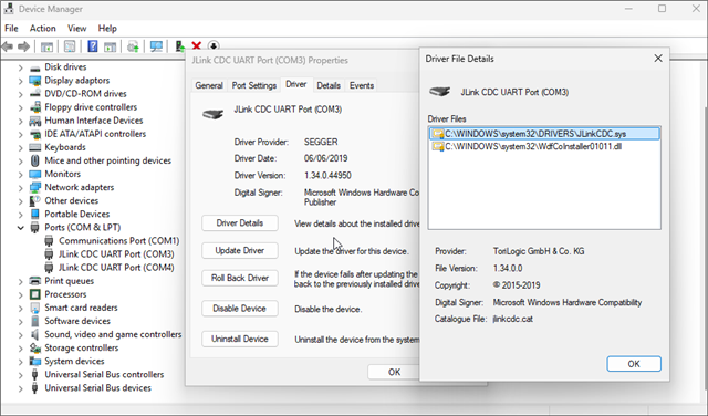

    When I try to manually set the driver for the board in windows Device Manager it refuses to accept the drivers in C:\Program Files\SEGGER\JLink_V876\USBDriver\x64. Are these the correct ones?
    When I check the drivers in use for my device, I get that.
    I also tried uninstalling J-Link and reinstalling it without the legacy USB drivers, but it still works. I can't reproduce the issue on my side.

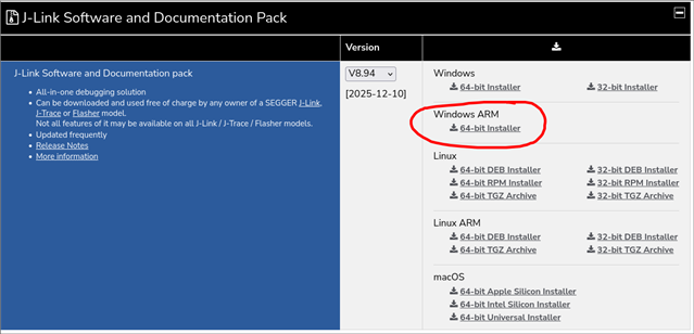

    Have you tried installing SEGGER J-Link with the windows ARM installer (link)
    I cannot test it on my side as I don't have an ARM64 computer on hand.
    Concerning nrfutil we unfortunately have no support on Windows arm64. We have a very basic version for Linux on arm64 here, it does not contain all the functionalities tho.
