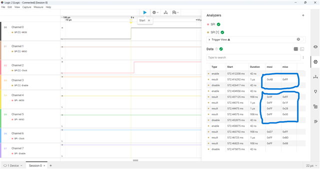

    I debugged on the MOSI and MISO pins. I am transmitting 0x9F on MOSI and getting 0x1F 0x28 0x00 on MISO, as expected. But the int ret = spi_transceive(spi_dev, &spi_cfg, &tx, &rx_set); API is returnig -5.
    I am observing that 0xAB is getting transmitted before 0x9F. I am not transmitting 0xAB from anywhere in the code.
    Attaching the spanshot for your reference.
