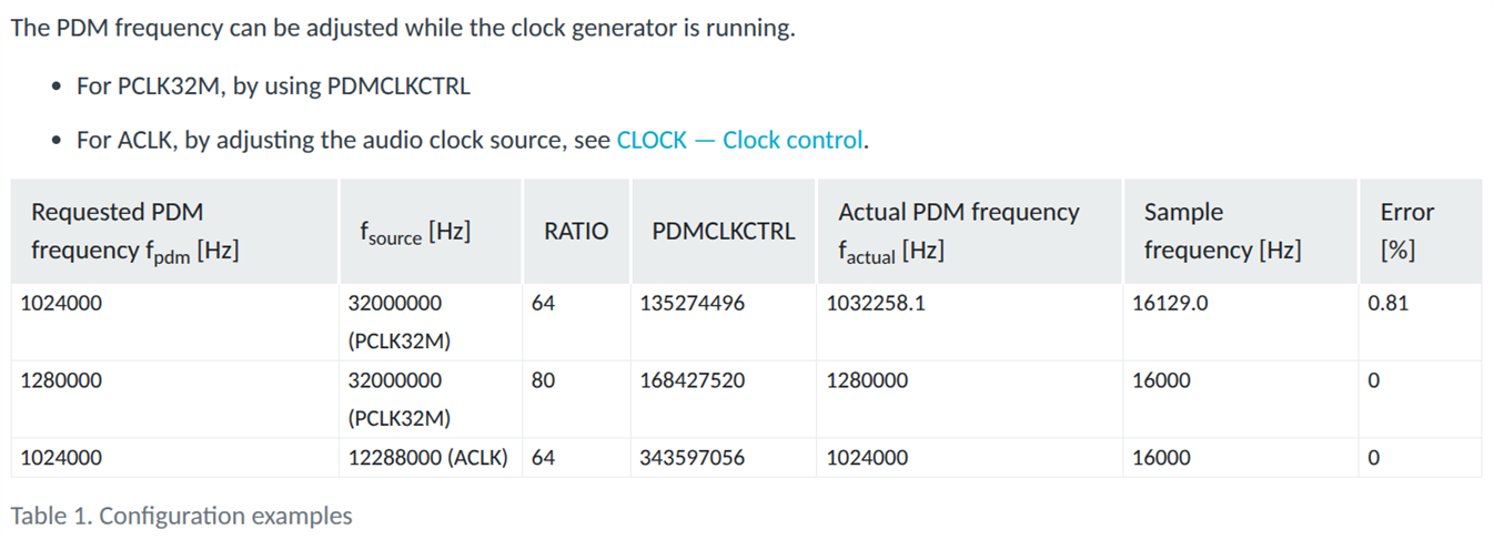

How do I adjust the PDM clock frequency and PDMCLKCTRL register value of the nRF5340?
I have a question after using the DMIC example on the nRF5340:
how do I adjust the PDM clock frequency to 1.28MHz, or how can I achieve this by changing the value of PDMCLKCTRL to 0x0A000000?
Below is my understanding after finding relevant documents. Please correct me if there are any errors, thank you.

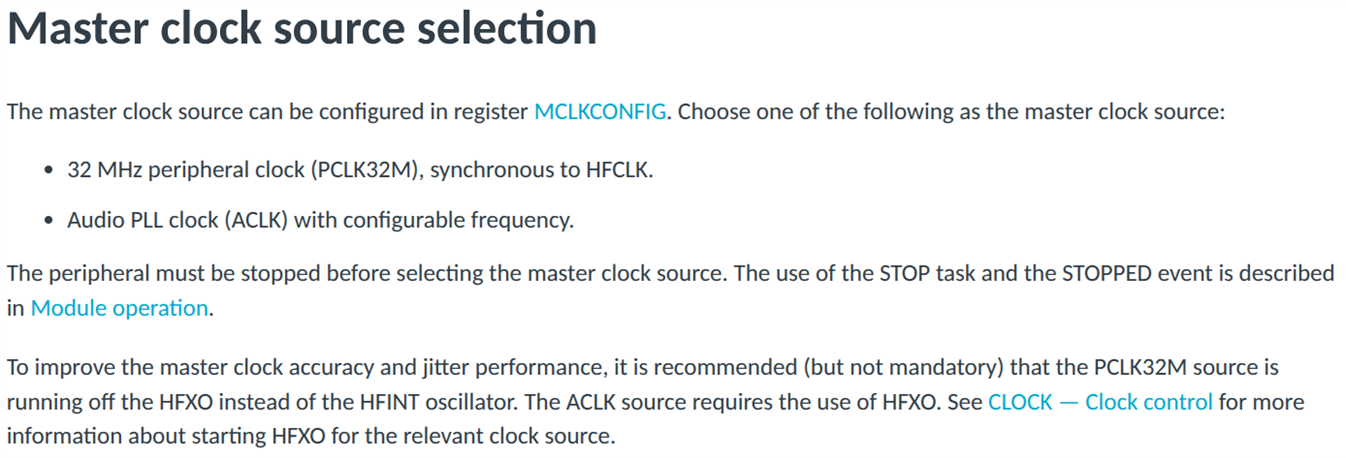

I saw the following explanation about PCLK32M and ACLK in the PDM Documentation.
However, in the following overlay file of the DMIC sample, the clock source of &pdm0 is ACLK.

Based on the above explanation and overlay file, does this mean I cannot change the PDM clock frequency to 1.28MHz using PDMCLKCTRL? Or how can I achieve this by modifying the overlay's clock-source to PCLK32M and modifying the main code?
If not using PDMCLKCTRL, how can I achieve this by modifying the main code of the DMIC sample using ACLK?

    If you want to source the PDM from the PCLK32M, you can set this in the clock-source in your device tree entry, like this:
    https://github.com/nrfconnect/sdk-zephyr/blob/ncs-v3.2.0/boards/seeed/xiao_ble/xiao_ble_nrf52840_sense.dts#L52
    then you can limit the min/max frequency setin the your "cfg" variable (type struct dmic_cfg)

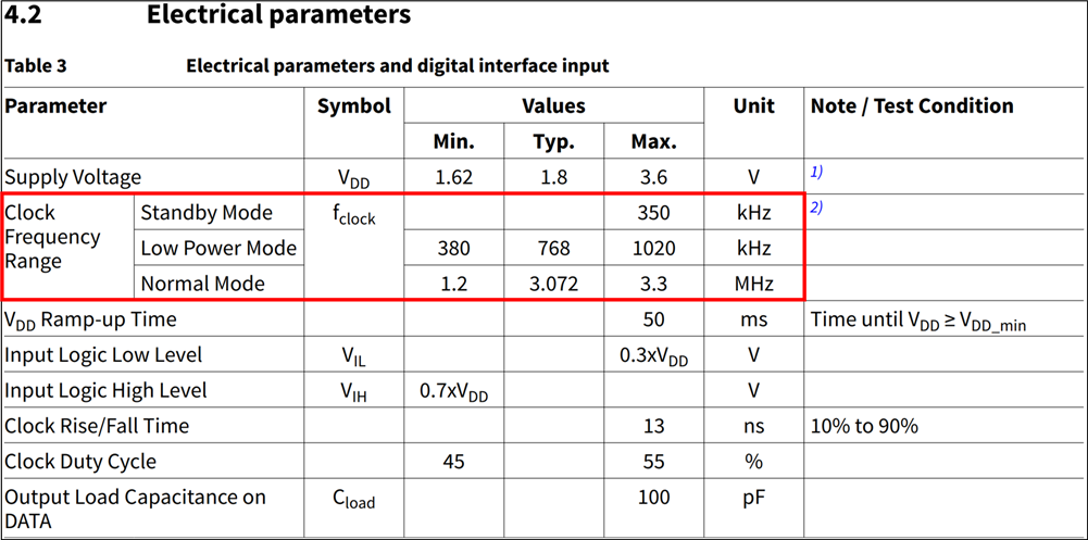

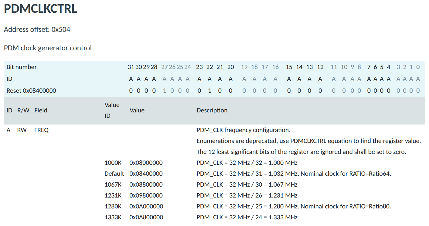

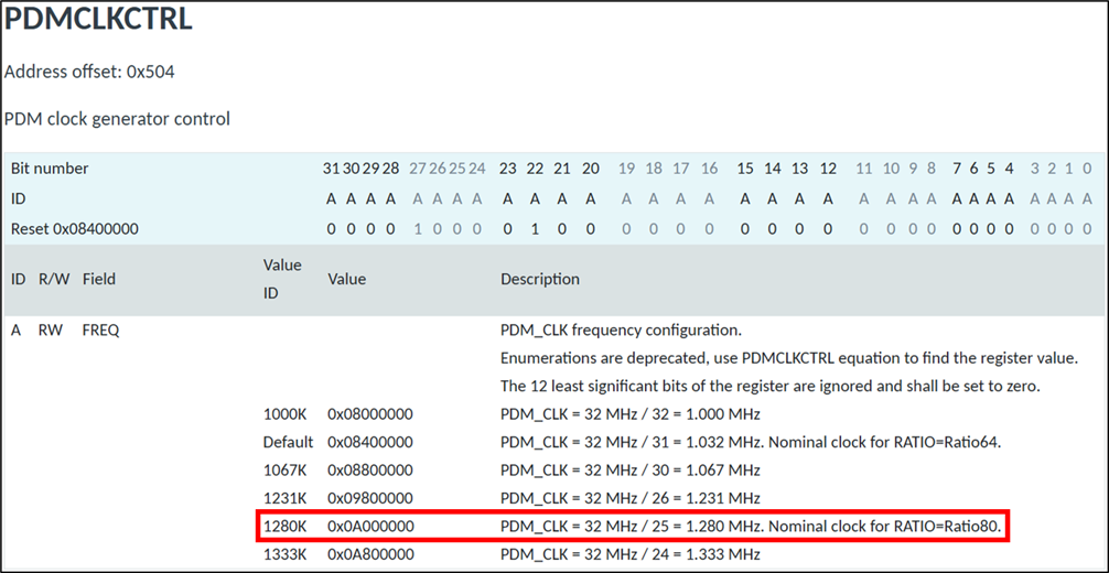

  • Hi Håkon,
    Sorry, I'm not very familiar with PDM and my explanation may not be clear enough.
    My project uses the nRF5340 as the SoC, which connects to the Infineon IM69D128SV01 microphone via a PDM interface.
    Based on the clock frequency range specified in section 4.2 Electrical parameters of the IM69D128SV01 datasheet, the low-power mode range is between 380kHz and 1020kHz, and the normal mode range is between 1.2MHz and 3.3MHz.
    The nRF5340's PDM clock frequency range is between 1MHz and 1.333MHz. Therefore, based on the PDM clock frequency range limitation, I currently plan to adjust the PDM clock frequency to 1.28MHz to meet the microphone's normal mode frequency range for initial testing.
    IM69D128SV01 datasheet: https://www.infineon.com/assets/row/public/documents/24/49/infineon-im69d128s-datasheet-en.pdf?fileId=8ac78c8c85c5e5aa0185dfa527036dad
    nRF5340 datasheet: https://docs-be.nordicsemi.com/bundle/ps_nrf5340/page/nRF5340_PS_v1.6.pdf?_LANG=enus
    Based on my previous test following your suggested modifications, I found that the microphone couldn't record any sound (currently, I'm only testing with human voices).
    I suspect it's because I both set the minimum and maximum frequencies of the "cfg" variable to 1.28MHz, causing the microphone to only record sound at that frequency.
    However, this isn't the result I want. I want to be able to record real-life sounds (mostly human voices) with the PDM clock frequency at 1.28MHz.
    By the way, I found the APIs "nrf_pdm_clock_set()" and "nrf_pdm_ratio_set()" online. It's "possibly" possible to set the PDM clock frequency to 1.28MHz using "nrf_pdm_clock_set()" via "NRF_PDM_FREQ_1280K". I'm not sure about the purpose of "nrf_pdm_ratio_set()".
    However, I've tested this version, and it still can't record any sound. Is my modification correct and effective? If not, is there any way to achieve this through code?

        /* Force PDMCLKCTRL to 1280K => 1.280 MHz */
        nrf_pdm_clock_set(NRF_PDM0, NRF_PDM_FREQ_1280K);
        /* Optional: choose RATIO=80 to get 16 kHz from 1.28 MHz */
        nrf_pdm_ratio_set(NRF_PDM0, NRF_PDM_RATIO_80X);
        nrf_pdm_gain_set(NRF_PDM0, NRF_PDM_GAIN_MAXIMUM, NRF_PDM_GAIN_MAXIMUM);

  • Hi Kevin,
    My apologies for the late reply. I have been out of the office.
    This sounds reasonable.
    Was there any errors or issues reported over the console?
    Did you check if there was any output on the GPIOs that you chose?
    It a bit unclear to me if everything worked as expected when you had a wider frequency range set. Could you clarify this?
    Håkon
