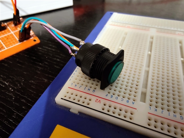

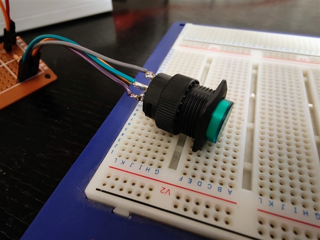

I'm trying to make the basic Button sample work but am having problems.
The physical button is a latching button. Press it and it moves in with a click and physically stays there. Press again and with a click, the latch releases and the button pops out.
This is the button:
Button in "out" state
Out state
Button in "in" state
In state
In terms of code, what happens is this: When I press the button in, I don't think a callback is received. When it is released to its "out" position, the button's interrupt callback function is repeatedly called, over and over again, and its state is always 1. I never see a state of 0 which is why I assume there's no callback when the button is put into its "in" state.

I assume the issue is that this is a latching button rather than a simple momentary push button but I'm not sure how to handle this in code.
