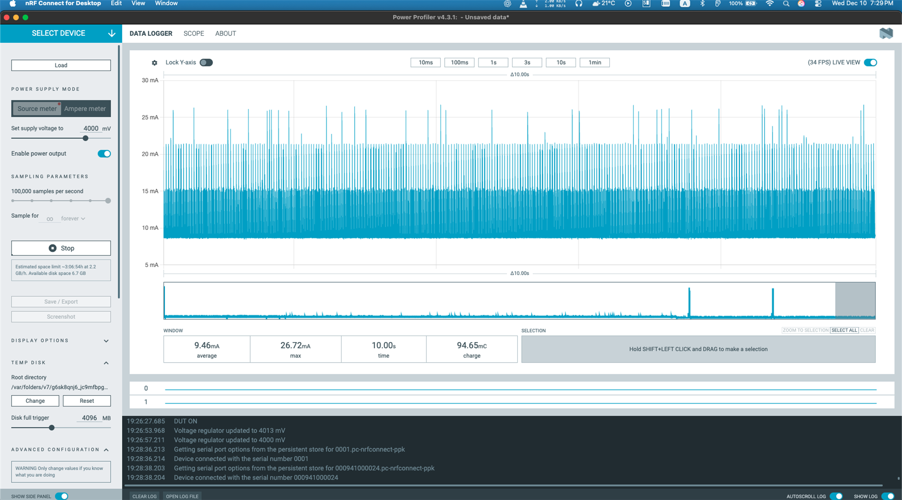

PPK2 shows 9–12 mA idle current on Mac/Linux laptops, but ~600–700µA on my team member's desktop for same custom nRF54L15 board
I’m facing a Power Profiler Kit II (PPK2) measurement discrepancy that appears to depend on the host PC, not the target board or firmware.

Observed behavior
  • On MacBook M2 (via UGREEN USB hub, since no USB-A port):
    • Device Idle current: 9–12 mA
  • On Lenovo laptop (USB-A):
    • Same result: ~9–12 mA

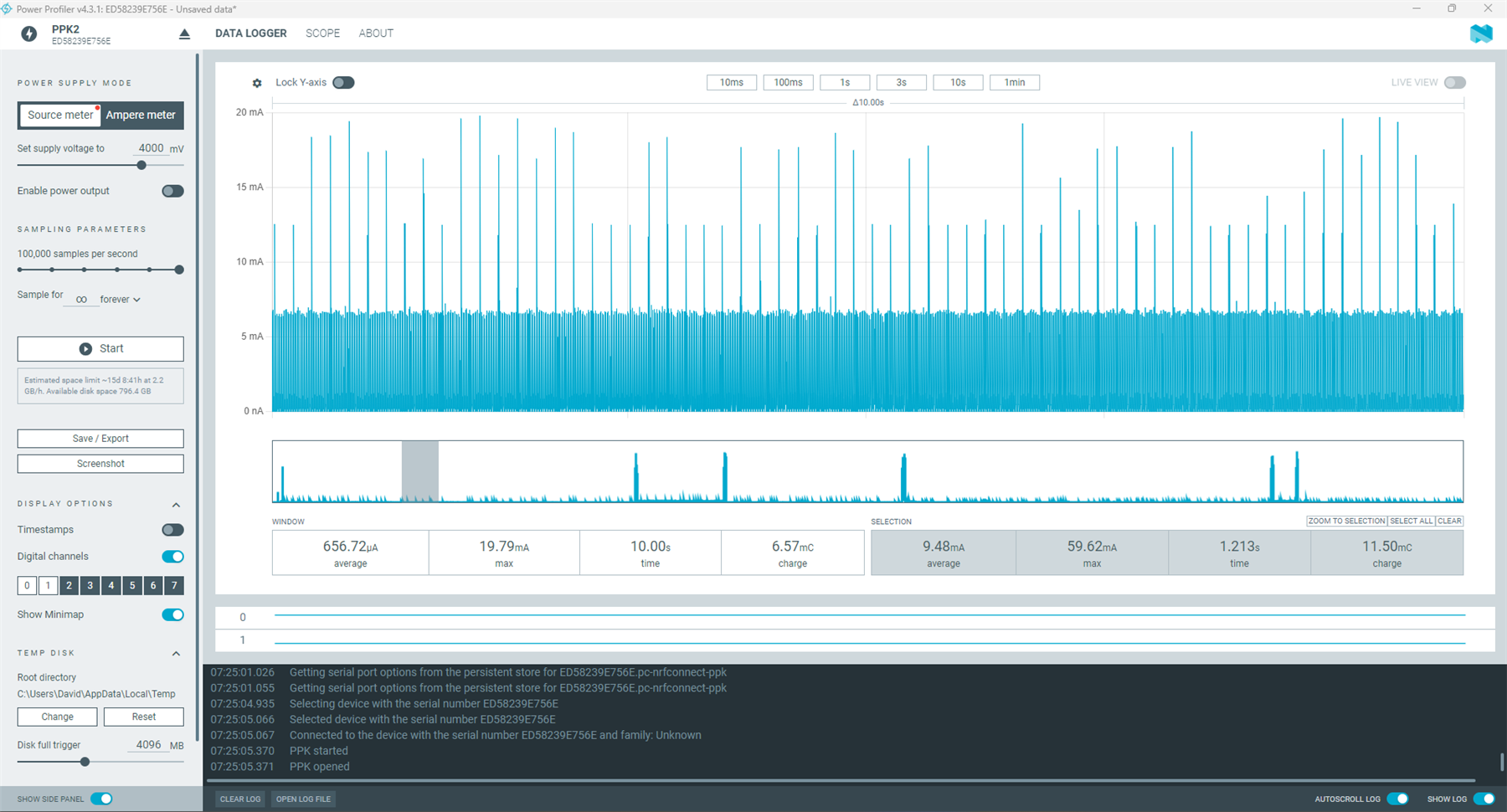

  • On team member’s desktop PC:
    • Idle current: ~600–700 µA (expected)
This is with the same board, same firmware, same PPK2, and same Power Profiler configuration.
Our previous version of the board was with nRF52840 MCU. Observed the same thing.
Additional observations
  • The high current is present even when:
    • UART and JTAG are disconnected
    • Board is in idle mode (no audio capture, no flash activity)
  • Disabling UART+JTAG increases current (~3-5mV) further (not expected),
  • The issue appears host-dependent, not target-dependent.
Measurement without UART + JTAG connected:
Measurement with UART + JTAG enabled:
Measurement from team member’s desktop PC with Windows 11 (expected idle current)
