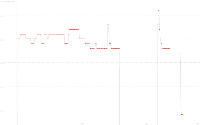

Any recommended ARB files for GPS testing with the CMW100/CMW500?

Could you please try lowering the signal generator output to around -150 dBm while keeping the same external LNA enabled, so that the effective level at the GNSS input is closer to -135 dBm, and then re-run the test? This would help us confirm whether the signal level is the cause of the CN0 fluctuations.

I tested by setting the instrument output power to -130 dBm, with the external LNA turned on and an attenuator added, adjusting the output power to -150 dBm. However, the CN0 value remains very low, reaching a maximum of only 25, and it still fluctuates, sometimes dropping to 0.

Thank you for the additional details. Based on our internal review of the test results, the observed behavior is consistent with the characteristics of the GNSS ARB waveform. The example ARB files typically contain a single GPS signal. At -130 dBm, the nRF9151 correctly tracks SV1 with CN0 around 38-42 dB-Hz, which is expected and indicates normal GNSS operation.
The tracking loss after ~2 minutes likely coincides with the rapid adjustment of the signal level to -150 dBm. Sudden power changes during tracking can cause temporary loss of lock. The signal is later reacquired with CN0 again above ~38 dBHz, confirming proper receiver behavior when the signal level is stable.
The additional fluctuating CN0 values (0-25 dBHz) correspond to acquisition attempts for other satellites rather than stable tracked signals. With ARB playback, these acquisition artifacts can be more visible, especially if there is some noise in the waveform or reflections in the conducted RF setup. In controlled GNSS simulator configurations generating a single GPS signal (like in single channel simulator mode), this effect is typically less pronounced.
We recommend keeping the signal level stable during measurement and ensuring the RF path is clean.
