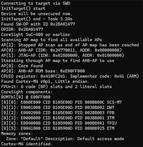

Using J-Link Commander, I am able to:
  • Detect the nRF52840 DK
  • Successfully program and run firmware on the board

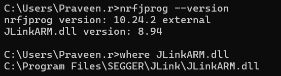

Both SEGGER Embedded Studio and J-Link are installed with their latest versions, and I have already tried:
  • Reinstalling both tools multiple times
  • Verifying that JLinkARM.dll is present and correctly resolved via where JLinkARM.dll
  • Confirming that nrfjprog can detect and use the J-Link DLL
  • Adding the J-Link installation directory to the system PATH
Despite this, SEGGER Embedded Studio is still unable to locate or load the J-Link library, preventing target connection, flashing, and debugging.
