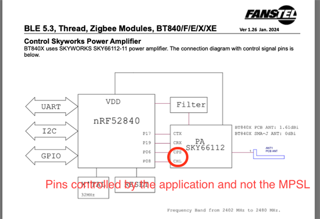

I just upgraded a product we developed using a Fanstel BT840X module (nrf52840 with a Skyworks SKY66112 amplifier) from SDK 2.3.0 to SDK 3.1.1 and I noticed that our radio signal quality has dropped enough that there's clearly some problem.
I am using the 802.15.4 hardware at a low level to send and receive packets from our gateway device to wireless devices which are currently still running the older SDK 2.3 code. I use nrf_802154_tx_power_set(22) to set the power level, nrf_802154_transmit_raw() to send, and nrf_802154_received_raw() to receive.

    There are quite many changes between SDK v2.3.0 and v3.1.0, but I haven't seen anything that should affect the FEM control. Are the pins highlighted below configured by your application to enable the FEM and high output mode (see table 6: https://www.skyworksinc.com/-/media/SkyWorks/Documents/Products/2201-2300/SKY66112-11_203225P.pdf)
    Vidar
  • Yes I think I have those configured correctly with the following code that's called at powerup:
    #define SKYWORKS_AMPLIFIER_CTX_PIN 17 // GPIO port 0
    #define SKYWORKS_AMPLIFIER_CRX_PIN 19 // GPIO port 0
    #define SKYWORKS_AMPLIFIER_CPS_PIN 6 // GPIO port 0
    #define SKYWORKS_AMPLIFIER_CHL_PIN 8 // GPIO port 0
    m_gpio_port_0 = (struct device *)(device_get_binding("GPIO_0"));
    m_gpio_port_1 = (struct device *)(device_get_binding("GPIO_1"));
    gpio_pin_configure(m_gpio_port_0, SKYWORKS_AMPLIFIER_CPS_PIN, GPIO_OUTPUT_INACTIVE); // GPIO_OUTPUT_INACTIVE Configures GPIO pin as output and initializes it to a logic 0.
    gpio_pin_configure(m_gpio_port_0, SKYWORKS_AMPLIFIER_CHL_PIN, GPIO_OUTPUT_ACTIVE); // GPIO_OUTPUT_ACTIVE Configures GPIO pin as output and initializes it to a logic 1.
  • Yes, your pin configuration appears to be correct. Ideally, it would be good if you could measure the CHL and CPS signals to confirm they are being driven to ‘1’ and ‘0’ respectively, but I realise the pads may be difficult to access. Alternatively, you could use the peripheral viewer in VS Code (or a similar tool) to read the GPIO configuration registers to confirm the setup, and also check the serial peripheral interfaces to ensure that none are configured to use the same pins.
