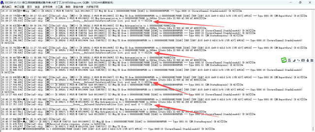

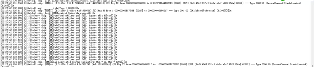

There are 5 Matter over Thread window covering devices which are already commissioned in 2 fabrics, the Apple HomePod & Google Home.
When only 1 device is powered on. The device is working fine.
When they turned on another device, the first device become unstable and was offline on Apple Home App.
(They have passed the Matter certification. And I'm sure all the 5 devices have different DAC and discriminators)
NCS version: v2.9.2
Here is the log:
2025.12.30.txt

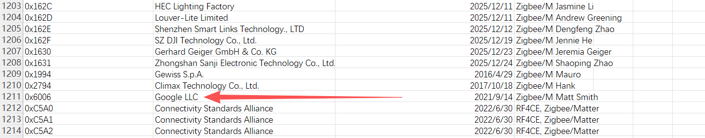

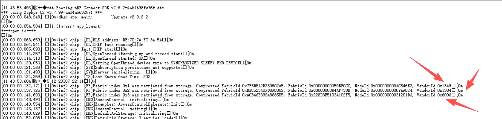

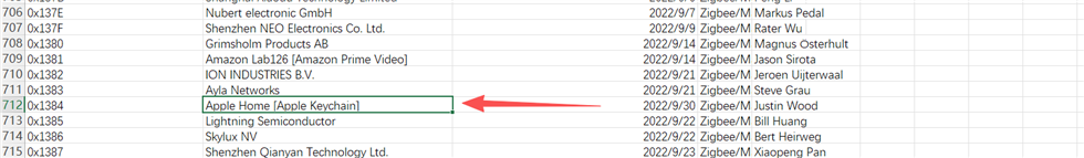

2. Fabrics
There are 2 fabrics at the beginning: Fabric 1 (DEC758BE) and Fabric 3 (50E8938D)
But I don't know which one is Google, and which one is Apple.

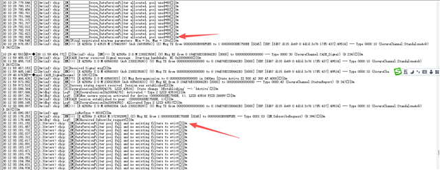

3. Preliminary analysis by AI
What the customer did at 17h59m is just turning on another device.
