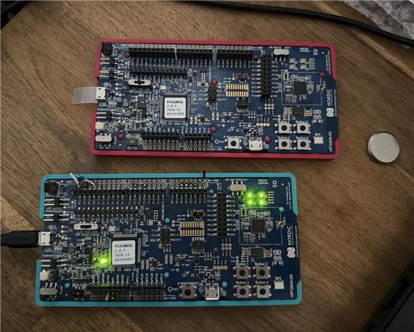

Hi, I took my old NRF52840 DK PCA10056 revision 2.0.1 and tried evaluating it today after few years. I am unable to connect to the target. I have 2 identical boards that were working few years ago on different machine.

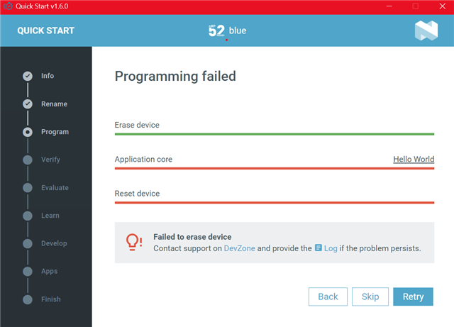

When I open nRF Connect for Desktop, the Quick Start detects my nRF52840 DK but fails when flashing. Here is the nRF Connnect for Desktop Quick Start log:

2025-12-31T11:52:29.643Z ERROR Failed to read the device information when setting up default external flash configuration. This is not critical, ignoring this error to allow the next operation to run, but we will probably hit it again on the next operation. The full error was: Device error: Setting the debug port SELECT register failed while powering up sys and debug regions (Unknown Error in J-Link DLL (error code =-1)).
This might indicate that the debug port is unavailable. Please double-check device power supply and SWD lines, and that SWD isn't disabled

I have two boards board with the same revision and both act the same. They were both working few years back, with Segger embedded studio on different machine, under Windows 10.

  • Hello! the issue in fact was in switch SW6 on pink board and switch SW9 on blue board. It seems that they have bad contacts. I cleaned the boards from dust and also the switches and it works, but I can still spot some "dead spots" in those 2 switches (eg when I move the lever slightly within the position). Thanks!
