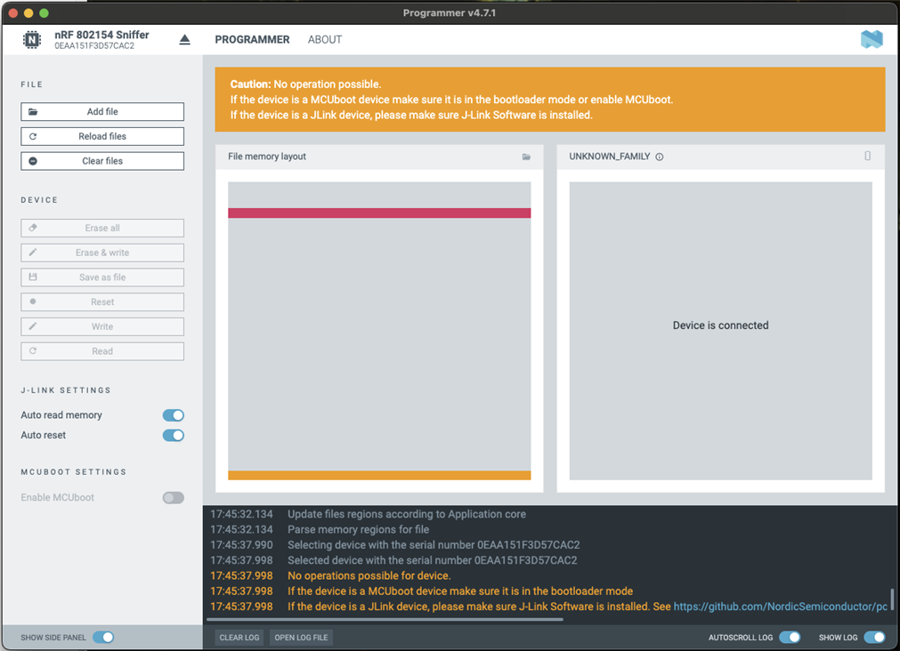

  • Hi, so I actually received the nrf52840 Dongle.
    I think I got too excited and try to flash it with the appropriate .hex file the following the documentation
    https://docs.nordicsemi.com/bundle/ug_sniffer_802154/page/UG/sniffer_802154/programming_firmware_802154.html
    However I get an error and it does not seem I can flash it again... I am very new to all this so I am probably doing something wrong or missing some steps.
    Below a capture of the programmer

  • Please try to enter DFU mode first by pressing the RESET button on the dongle. DFU mode is indicated by slow blinking of the RED LED.
  • Thank you Vidar,
    I now have been able to flash the dongle successfully but still no luck with seeing it in the capture devices in Wireshark.

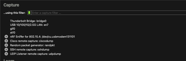

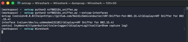

  • On macOS, GUI applications opened from "Finder" do not inherit the same environment as the Terminal. As a result, Wireshark may be invoking a different Python interpreter than the one used when you execute nrf802154_sniffer.py directly from the Terminal, and therefore may not have access to the required pyserial dependency.
    As a test, please try opening Wireshark from the terminal as I did here:
    nRF sniffer interace:
    I'm on macOS v26.2, but I don't think the OS version is relevant to the problem you are experiencing.
  • Thank you very much! That was it.
    I did flash the dongle again because I ended up trying another version of the hex file but I indeed need to open Wireshark via the terminal as you suggested, otherwise I can't see the dongle.
