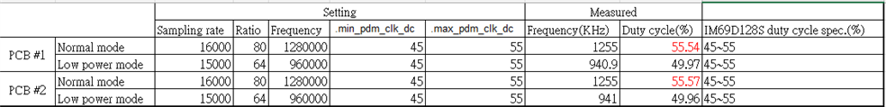

1. At nRF5340 datasheet page 420, the PDM duty cycle is 40%~60%, any register can tune duty cycle? Or it's nRF5340 variation tolerance?
2. Since our DMIC IM69D128S duty cycle spec. is 45%~55%, we test 2 pcs PCB and find if we tune frequency, the duty cycle will change(see below pic.), can we use this way to tune duty cycle or not?
