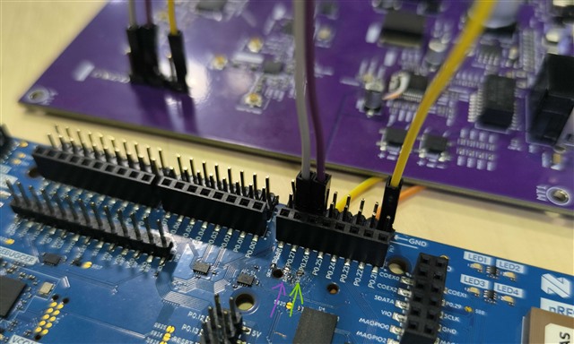

  • Hardware: external nRF9151 module/chip only; wires soldered directly to pads
  • Behavior: after flashing SLM, no UART banner/AT response
Programming status (confirmed)
  • The external module can be programmed via SWD successfully.
  • nRF Connect / Programmer confirms the image was written correctly (flash operation completes without errors).
  • The behavior diverges after flashing: DK runs and responds; external target is silent on UART.

Additional test using the nRF9151-DK as a power/UART host (still fails)
  • The external module was connected to the nRF9151-DK.
  • The DK’s onboard modem TX/RX path was opened/disconnected to isolate the DK’s modem and reroute the DK UART TX/RX to the external module instead.
  • The external module was powered using the DK native rails (5 V / 1.8 V) and tested through the DK’s UART interface.
  • Result: SLM still does not respond on UART.

  • Thank you Syed for the quick response,
    1. We are using the "nrf9151dk_serial_lte_modem_2025-08-14_6c6e5b32.hex" file on both configurations. Using the DK, the pins containing the UART are P0.27/P0.26, verified as we used a version of our board with pins for RX, TX, GND and 3V3, connecting RX, TX and GND with the powered DK we have a communication with P0.27/P0.26.
    2. I will test the DTR pin.
    3. In DK, the VDD_GPIO is 1.8V and we have communication.
    4. Thank you for reassuring this aspect, we will have the boot sequence in mind.
    I will be testing the uart2 pins and modifying the devicetree and compiling the project.

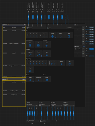

  • Hi Syed,
    Pulling the P0.31 LOW returned no difference, but as I was measuring the pins I came across the P0.29 and P0.28 pins as HIGH.
    This led me to compile the SERIAL_LTE_MODEM sample from nRF SDK v3.1.1 as is and it showed me the devicetree:
    It shows that the uart0 is indeed P0.27/P0.26 (TX/RX) and uart1 as P0.29/P0.28 (TX/RX), there is no mention to a DTR (not that I found), the P0.31 is used as SCL for i2c2.
