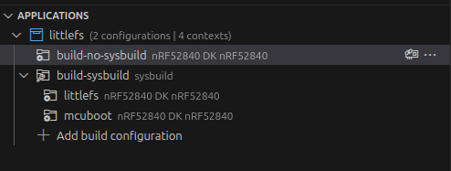

  • I'm not sure how to build a multi image without sysbuild.
    I checked out my 'mcuboot-3.2.1' branch from my example repo and created two build configurations in VS Code, one with sysbuild and one without.
    That created an applications entry in VS Code that looks like:
    So it doesn't look like VS Code created multi images without using sysbuild.
    If I flash the 'build-no-sysbuild' image, it works in that it correctly mounts the LittleFS partitions on the external flash, but it didn't use MCUboot.
    If I flash the 'build-sysbuild' images, it uses MCUboot but doesn't mount the partitions from external flash.
    Jeff
