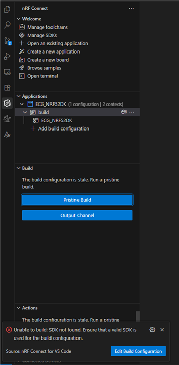

Help needed with Pristine build in vs code
I mean like when ever i click pristine build in the vs code i am getting this below error
"Unable to build: SDK not found. Ensure that a valid SDK is used for the build configuration."
but the build is getting done when it is done in the terminal

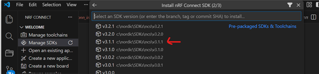

    Does that list v3.1.1 under "sdks", like this:
      "sdks": [
          "version": "v3.2.1",
          "path": "c:\\ncs\\v3.2.1"
          "version": "v3.2.0",
          "path": "c:\\ncs\\v3.2.0"
          "version": "v3.1.1",
          "path": "c:\\ncs\\v3.1.1"
          "version": "v3.1.0",
          "path": "c:\\ncs\\v3.1.0"
    If not, can you please try to run the following command? (does require a standalone installation of nrfutil):
    nrfutil sdk-manager toolchain launch --terminal --ncs-version v3.1.1 (this will open a new window, use this one for the rest of the commands)
    cd into the root folder of ncs v3.1.1, e.g. c:\ncs\v3.1.1
    run "west update" and wait for it to finish. Does it indicate any errors? When this is done, close VS Code and relaunch it. Does it work now? If not, can you generate the support information once more, and upload this as well?

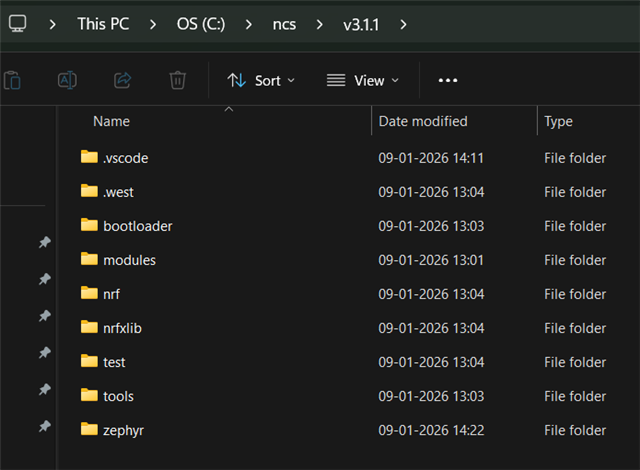

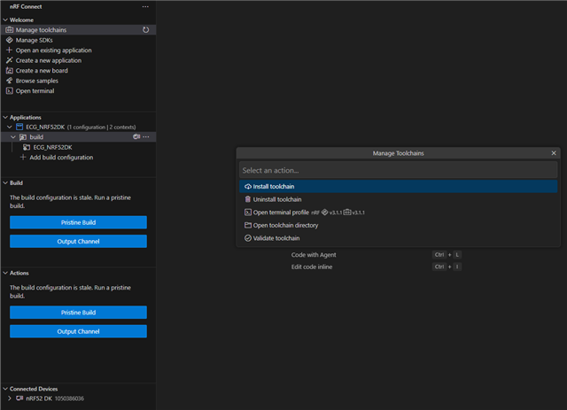

  • this is the ncs folder which i am having.

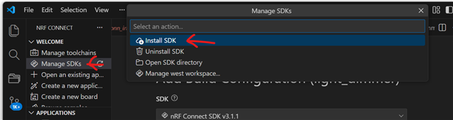

    and my manage tool chain menu looks like the above, and moreover when i click the open sdk directory in the manage sdk menu it is opening the C:\ncs\v3.1.1 folder only, am i missing something, it is a nRf Connect SDK (NCS) right

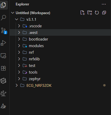

  • Can you try: in VS Code, press file -> open folder, and open the root folder of your SDK (the one named v3.1.1). Then press the "+" sign ("open an existing application"), navigate to your application folder, and select "Open". This adds the application to the workspace, without removing the SDK from the workspace. Then you can generate a new build configuration:
    And you should see the SDK version and toolchain version in the two upper options.
    Edvin

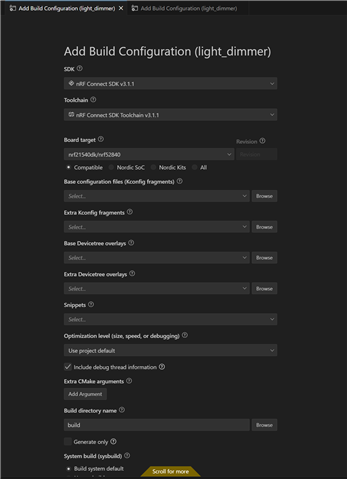

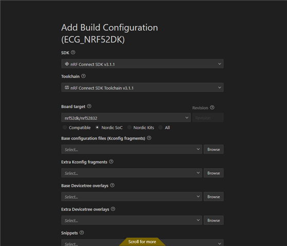

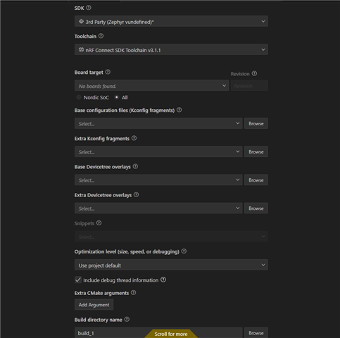

  • so basically i tried what you were saying,
    and even added the build configuration and it still looks like this
    it dint change anything here
    regards
    vishva

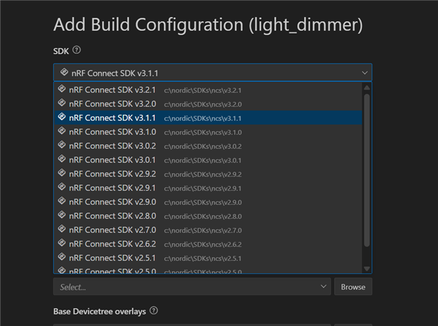

  • When you create your build configuration, does v3.1.1 show up as an option? And how about the toolchain? Does it appear there?
    Does it build the first time after you click "generate and build" in the "Add Build Configuration" tab, but then later doesn't find the SDK version? Or does it not build at all the first time around either?
    Is this only an issue for v3.1.1? Or is it an issue for older NCS versions as well? Can you try with e.g. v3.0.1 and see if the issue is the same?
    Edvin
