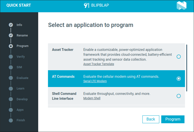

    • First, flash the device with the Serial LTE Modem. You can do it by running the "Quick start" application and selecting the "AT Commands" program when asking which program to flash.

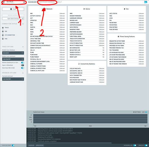

    • Once the Serial LTE Modem has been flashed, Open the "Cellular Monitor" application, connect to your device and go to "certificate manager"

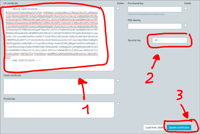

    • Then paste the certificate content to the "CA certificate" field, Write "24" in the "Security tag" field and press "Update certificates".
    After that, you should have pushed the certificate to your device. You can program the DK back with your firmware and it should work fine.
