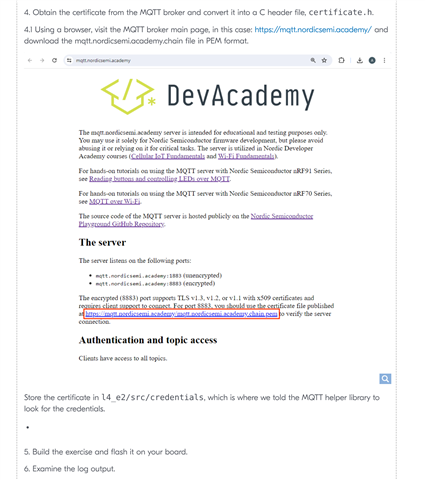

We are running some internal training on cellular, and it seems that Lesson 4, Exercise 2 is missing something (in the tab for NCS v3.2.0); the instructions to provide the build system with the server certificate seem to be truncated (see image below):
missing part in section 4?
Even leaving aside the course content itself, it seems the solution (in l4_e2_sol) gets a -111 (connection refused) when trying to connect to the nordic academy MQTT broker:

This seems to be specific to v3.2.0: the repo at https://github.com/NordicDeveloperAcademy/cell-fund has 3 commits (4808121, b525c06 and c2c1ce0), all with the same commit message that fundamentally altered the lesson, removing the crt_to_header python script and moving the exercise to the MQTT Helper library.
The exercise text also mentions including modem_key_mgmt.h, which was a necessary step in the old mqtt_connection.c file for v3.1.0, but has been removed since.
In short, it seems that updating l4_e2 to NCS v3.2.0 somehow went wrong and the course is now out of sync with the code.
