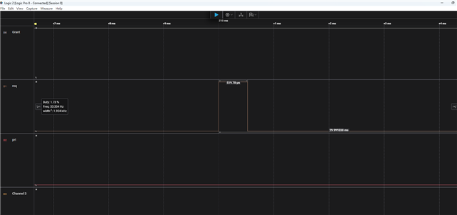

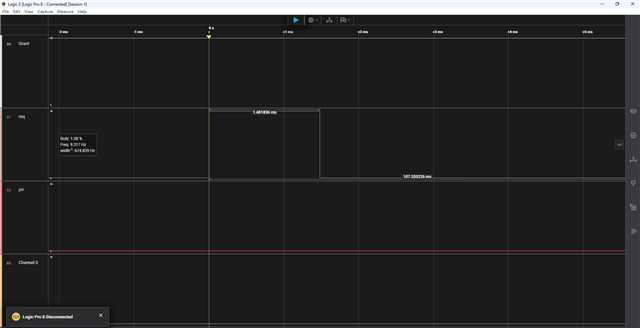

During testing, I observed that when the program is advertising, there is a pulse of approximately 1.4ms on the req-gpios. When connected, there is a pulse of approximately 519us on the req-gpios.
BLE advertising req-gpio pulse is around 1.4ms
BLE connected req-gpio pulse is around 519us

Is the pulse on req-gpios exactly the duration for which the Bluetooth radio needs to be used? For example, if the pulse on req-gpios is 519us during a Bluetooth connection, can it be understood that the nRF54L15 requires the RF for 519us?
    Yes, there are some added delays, etc., to ensure that any external circuitry is being switched/told about this change, but generally, yes.
