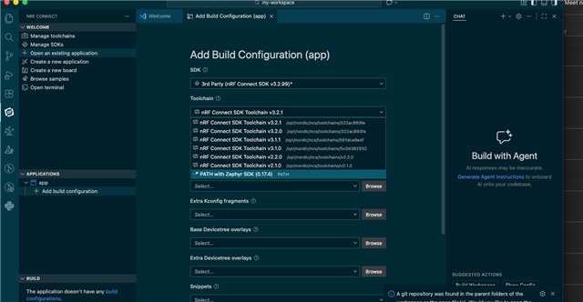

5) After that I could run "add build configuration" & build, but I was not able to select the stock zephyr toolchain.  The application built with the nordic toolchain selected. (Application frame shows Zephyr v4.3.0 as SDK. Action frame shows "nRF Connect SDK Toolchain v2.8.0)

And I observe the application built with the stock toolchain, not the nordic one. I also observe the NRF CONNECT frames show "build configuration stale. Run pristine build".  Selecting "Pristine Build" results in a "Unable to build: SDK not found." error.
Help in installing a third party toolchain would be appreciated. (Or really just selecting it: "west sdk install" works fine to get it, I just can't select it.)

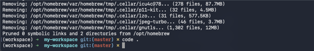

    First time I'm trying to use the Zephyr SDK instead of the NCS toolchain on macOS, but it seems to work fine as long as I open VS code from the terminal to let it inherit the build environment. Could you try the same on your end to see if it works for you as well?
    Opening VS code from terminal by running "code ." from the workspace directory
    (https://code.visualstudio.com/docs/setup/mac#_launch-vs-code-from-the-command-line):

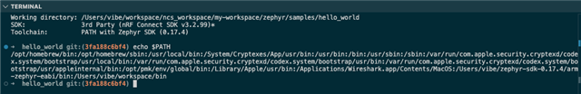

    As you correctly point out, starting vs-code from a terminal the west environment activated allows for selection of the stock toolchains in build. Once the builds complete, the `actions` pane shows the selected toolchain. (And more importantly, the proper toolchain is used -- turns out the three projects I am working on now -- 1 with nordic sdk, one with zephyr-stock 4.3.0 & one with zephyr-stock 3.7.1LTS all require their corresponding toolchains to properly complile code.)

    No problem. Looking back I can see that my answer may have sounded more like a workaround than a proper solution. What’s happening is that before looking for installed Zephyr SDKs in the CMake package registry, the extension checks if build tools such as west are available on PATH. Only if they are found will the installed/registered Zephyr SDK(s) be displayed. (NCS toolchains don’t require this check since they bundle the build tools.) Another solution is update your PATH in ~/.zshrc to include the path to where you your 'west' executable is located. Then you won’t need to launch VS Code from the terminal to inherit a working build environment.
