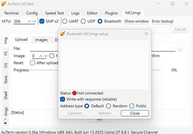

    Is it an option to use AuTerm which is a GUI app (https://docs.nordicsemi.com/bundle/ncs-latest/page/zephyr/services/device_mgmt/mcumgr.html#toolslibraries)? Another option is to try this cli tool here https://github.com/thedjnK/qtmgmt
    Vidar

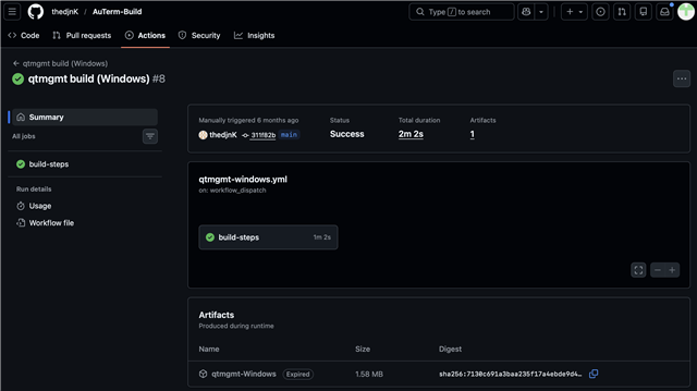

  • Hi Vidar,
    I’m not sure how to run AuTerm using the command line. From what I understand, if command-line usage is required, it seems that qtmgmt needs to be used instead.
    However, I’m unable to download a pre-built executable of qtmgmt.
    I would like to ask whether you could provide an example of commands that have been successfully executed using this tool, so that I can use them for testing purposes.
    Thanks!!
    Mike
  • Hi Mike,
    AuTerm has a GUI only and cannot be used from the command line. That is why I mentioned qtmgmt, but this must be built from source it seems. I have not tried this tool myself. Internally for automated testing. we are using the mcumgr client script on linux
