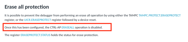

However, we observe that using ERASEALL or the nrfutil device recover command erases the KMU contents, including the provisioned public key. After recovery, the device can be flashed with a new firmware image, which will then run.
  • We want to store the public key in one-time programmable (OTP / eFuse) memory
  • Once provisioned, the key must not be erasable, changeable, or replaceable, even after ERASEALL or recovery
  • Only firmware correctly signed with the corresponding private key should ever boot
  • If verification fails, the device should remain locked / unusable
Is there any such facility available in the NRF54L15 device along with NRF SDK
