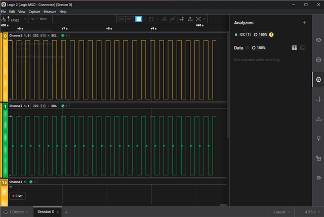

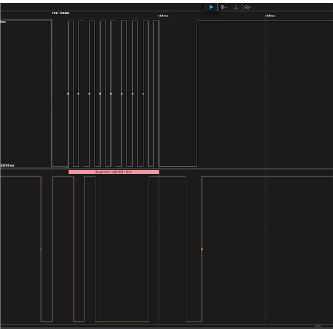

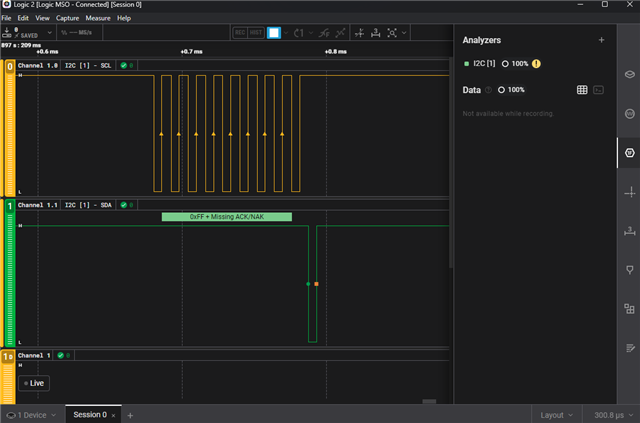

The I2C (TWIM) SCL line functions correctly, but the SDA line is not being driven by the peripheral. During I2C transactions, we observe 9 SCL clock pulses (correct for address + ACK), but SDA remains high throughout - it never toggles for the address bits. Since we are using pins  P03 for SDA and P04 for SCL we have to use i2c30 and because we are using TFM we have already disabled its logging with:
CONFIG_TFM_SECURE_UART=n
CONFIG_TFM_LOG_LEVEL_SILENCE=y
I'm having issue specifically with SDA line. No matter what i do i cant seem to get it working the communication always looks like this (see attached image from logic analyzer):
I have verified that the connection to my logic analyzer is good since if I manually toggle the pins manually they both work.
I have also tried building an app without any security features and all other functions and files removed. Currently my project is just i2c communication and i cant get it to work.
Is this some issue because of TFM, is it a driver issue or do i have something configured wrong. Attached you will also find my prj.conf, overlay file and the main file.
Do you see any error in my code?
