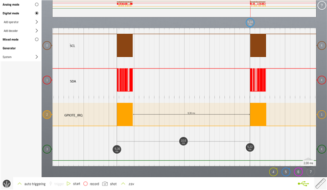

I discovered that the BLE stack, along with Timer0 and RTC1, is running at priority level 0 and the SDK does not allow other interrupts running with priority = 0.
My I2C sniffer uses the GPIO interrupt to evaluate the edges of the SDA and SCL signals. The I2C communication runs at approximately 83 kHz, and I need the shortest possible interrupt latency to capture the signals correctly.
On the other hand, only a very short interrupt execution time (< 3us) is required.
Therefore, I tried a hack without permission of the SDK and  moved the interrupts use by the BLE-stack to priority level 1.

Now I tried a test with a timer-3 interrupt, which I programmed without the SDK using direct register access and set the timer interrupt priority to level 0.
The interrupt service routine does nothing except clearing the interrupt event.
void TIMER3_IRQHandler(void)
  nrf_timer->EVENTS_COMPARE[0] = 0;
Unfortunately, I get an application error as soon as the timer interrupt is executet.
<error> app: SOFTDEVICE: INVALID MEMORY ACCESS
- Is there perhaps still a small chance of getting my interrupt to work with priority 0?
- What triggers the error? Or how does the SDK manage to figure out that someone is above it?

  • Since my attempt is doomed to failure and a minimal interrupt delay is not possible on the nRF5380 , I went over to ESP32.S3. Unless someone has another idea regarding my second question above, how one might be able to pause the BLE stack for some ms.There might be also the option of using a Nordic Dual Core (nRF5340). Unfortunately, there isn't a compact board available for it yet. The ESP32 solution is now working perfectly.
  • There are two other ways to achieve the goals. Both work around the fact that the Softdevice will eclipse any interrupt code for periods of time.
    Serial protocols such as i2c and SENT can be decoded by latching edge transition times into multiple Timer CC registers and with the result processed periodically; the more Timers and Timer CC registers are available the longer the SD eclipse interval can be without data loss. I wrote some code to do this for SENT (Single Edge Nibble Transfer) used in modern vehicles which works well; SENT is 1-wire rather than 2-wire, but the principle is the same for i2c/twi except twice the number of CC registers would be required for a given number of edges. There is a rather long post which will provide timing details:
     sent-protocol-based-sensor-configuration-with-nrf
    The other option is to leverage a sampling peripheral which has DMA-into-buffer availability, unaffected by the SD, for example the SAADC. Not particularly efficient, but ok for sniffing slow periodic messages.
