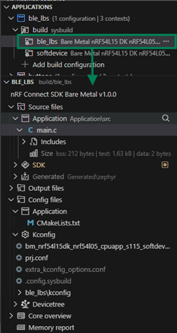

5. The working projects are missing "Source" folder in project tree on NRF CONNECT panel, only "Output files" and "Config files". Sure the sources can be accessed through Explorer panel, but as far as I understand they should be listed in the project tree as well. Interestingly, the faulty projects from #3 do list "Source" folder, but inside there's only a "Missing compile_commands.json Click to regenerate" link (which still yields the same faulty result as above).
- resolved

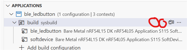

    To answer your question about why seemingly the source files are missing from the application window, make sure to select the application build, like this:

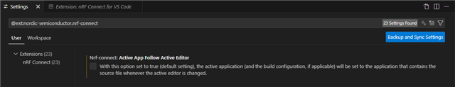

    Also, personally I like to uncheck this one to avoid that is selects a different build if you by accident click on a file outside of the current project:

    Selecting the application build revealed the Sources folder Thumbsup So #5 resolved.
    "Active App Follows..." checkbox removed, good idea.

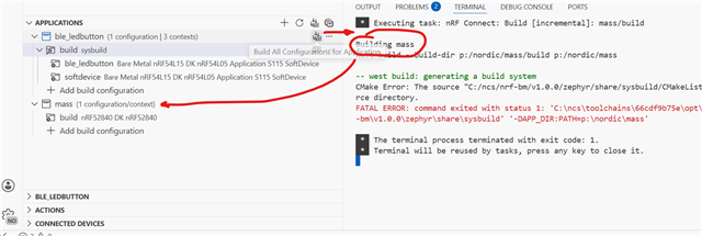

    7. Pressing "Build All Configurations" on the application plank runs build process for the different project:

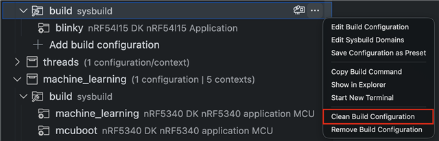

    8. Is it possible to add "Build" and "Clean and Build" buttons to the configuration plank ? This would also resolve the potential issue with an active project focus.

  • Hi Sergey,
    I have forwarded the input to the VS code extension team, the feedback for now is that it can partly be done by:
    Edit1: Screenshot not from Bare Metal (BM) SDK, but same should be possible with BM SDK in VS code also.

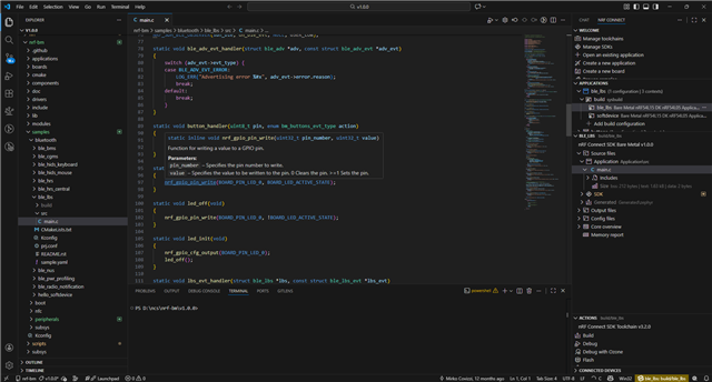

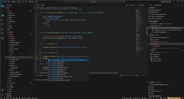

    I am not sure I understand, this is a screenshot of my setup, what are you missing?
    This is me hovering over a function:
    This is me trying to add an api call:
    Kenneth

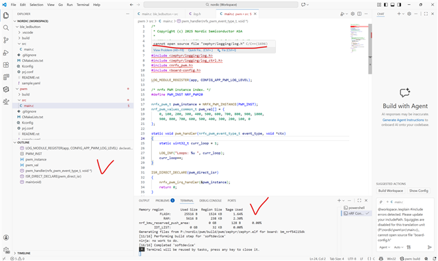

  • This is what's going on:
    PWM demo from BM package - builds correctly, local code navigation is OK, but cannot parse a single header and hence no cross-file navigation.
    Another similar project you can see on the same screenshot (ble_ledbutton which is a ble_lbs demo) has the cross-file navigation working just fine.
    Both utilize default build configuration, yet very different outcome. Any suggestion what to check ?
