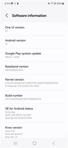

Our product encountered a problem with DFU: the device fails to perform DFU mode on an Android phone during working. Phone specifications: [Sumsung Galaxy s23]--[Android version 14]--[DFU App:v2.9.0].
However, I can perform DFU mode without issues using another Android phone[Redmi Note 8]--[Android 11RKQ1.201004.002]--[DFU APP:v2.9.0] and an iPhone[13Pro,18.1.1]--[DFU APP: v6.0.1]

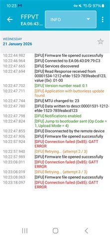

  • Hi hung bi
    this is the log from android 14 - sumsung galaxy s23.

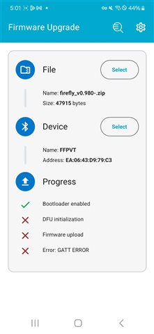

  • SDK11_DFU_FAILED.7z
    Hi  Elfving
    I'm very sorry for not replying to your message until so late. I've been extremely busy recently QAQ
    I created the smallest example to assist you in troubleshooting the issue.
    I conducted experiments on the pca10040 development board and found that it is indeed impossible to perform DFU (unless entering the bootloader, in which case DFU can be successfully accomplished)
    The error message should be consistent.

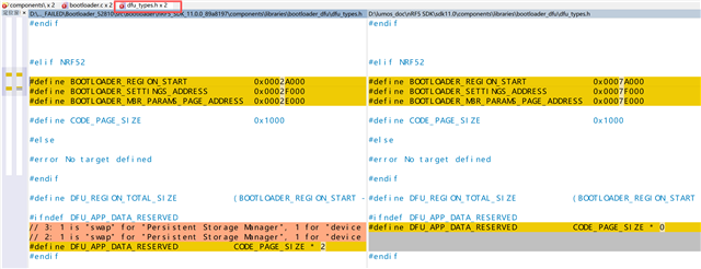

    Our significant changes in the bootloader:
    1. The address of the boot loader has been modified.(adapt to the nRF52810 (with 192 KB Flash)
    2. Modified the Bluetooth name and the method for booting the bootloader

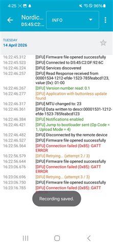

    I am using Buttonless DFU. I connect to the application first and then trigger the DFU process via the Android  DFU app. This is what I meant by 'impossible to perform DFU unless entering the bootloader' — I found that the software trigger from the app often fails, but if I manually enter the bootloader (via buttons), it works.
    YES. I had reset bluetooth setting.
    - Which app did you use on the phone ? Did you use nRF Device Firmware Update app ? SDK v11 is really old so there is a chance that it is not compatible with the buttonless DFU on SDK v11
    I conducted the test using DFU. Version number: 2.11.0 (build 26021106)
    - Could you try to check the BLE  address of the bootloader after you switch from application to bootloader. You can use nRF Connect Device Manager to check . Usually it would be the same address as the application or a +1 address to the application's address.
    • Manual Entry Test: I tested entering the bootloader manually (by holding the button during reset). In this case, the device advertises correctly, and I can see that the BLE address is indeed Application Address + 1.
    • Buttonless DFU Issue: When I trigger DFU from the application (Buttonless), the LED indicators on my board suggest that the device has successfully passed the application's validation and entered the bootloader stage.
     However, even though the LEDs show it is in the bootloader, I cannot find any ble advertisement (not even the +1 address) in the nRF Connect app.

  • Hi Zicongkuang,
    I'm sorry that I haven't got time to actually test your code yet.
    My suggestion for you in the mean time is to try to check what happen when you try to switch from the application to the bootloader.
    Please be noted that the bootloader can be debugged the same as a normal application. You just need to remove any code optimization when building to enable debugging. The size of the bootloader may be increased when you remove code optimization so you may need to move the bootloader down in the flash to give more space. You can also think of adding logging to the bootloader to make it easy to debug.
    I noticed that you enabled 2 pages for DFU_APP_DATA_RESERVED . Please make sure you set the location of the app data correctly so that it doesn't overlap with the bootloader.
