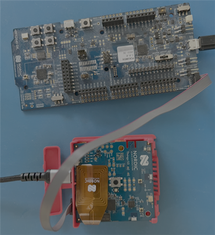

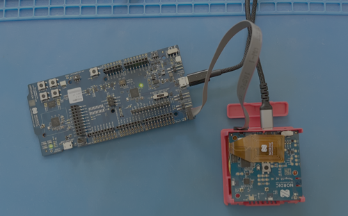

I am trying to flash and use the debugger on a nrf52840 DK to flash a Thingy53, using the ribbon connector as outlined in this video. I tried to follow the steps in this post:

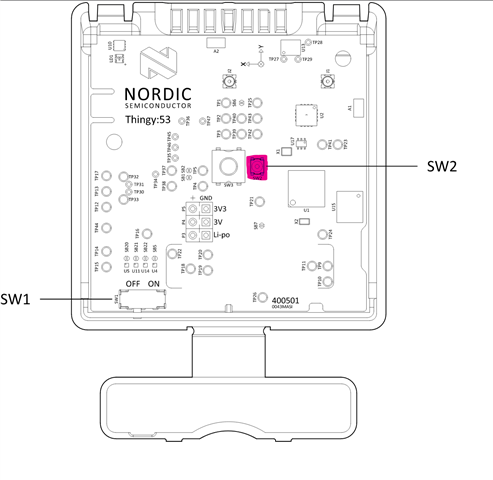

  1. Open nRF Connect for Desktop -> Programmer
  2. Connect Thingy:53 and nRF52840 DK as in the image you uploaded.
    Yurii_B said:
  3. Turn the thingy off. Turn on the DK.
  4. Then press and hold SW2 (marked in pink, located next to SW3) while flipping SW1 to 'on''.
  5. Verify that "Bootloader Thingy:53" is visible in Programmer. This indicates a bootlader is present

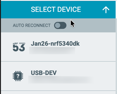

But I don't see the nrf5340 in my nrfConnect for Visual Studio Code:
Like it's shown in the video:
I get this error:
-- west flash: using runner nrfutil
-- runners.nrfutil: reset after flashing requested
-- runners.nrfutil: Flashing file: /Users/xxxxxxxxxx/Projects/xxxxxx/xxxxxx/xxxxxx/build_thingy53/merged_CPUNET.hex
Error: One or more batch tasks failed:
 * xxxxxxxxxx: Device error: Setting the debug port SELECT register failed while powering up sys and debug regions (Unknown Error in J-Link DLL (error code =-1)).
   This might indicate that the debug port is unavailable. Please double-check device power supply and SWD lines, and that SWD isn't disabled (Generic)
FATAL ERROR: command exited with status 1: nrfutil --json device x-execute-batch --batch-path /Users/xxxxxxxxxx/Projects/xxxxxx/xxxxxx/xxxxxx/build_thingy53/generated_nrfutil_batch.json --serial-number xxxxxxxxxx
