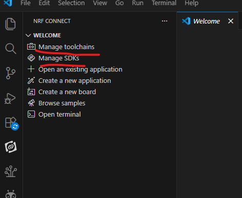

    Please uninstall everything, also delete any folders in the c:/ncs path and then:
    1. Install the nRF Command Lines Tools latest version.
    2. Make sure you have the latest version of J-Link on your PC.
    3. Install nRF Connect for VSCode extension.
    4. After installing the extension, then you can install the required SDK and the matching toolchain from:
      say for eg,
    Manage toolchain -> Install toolchain -> Global -> v3.1.1
    Manage SDK -> Install SDK -> nRF Connect SDK -> v3.1.1
    This should help.
    -Priyanka
